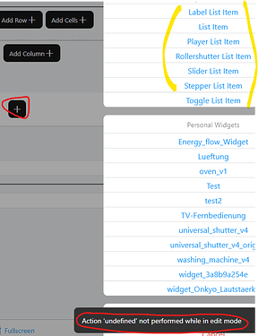

I have other issues in MainUI with “List Cards”. I wonder if someone else face them?
They appear also on a different browsers, cleaned (OH / Browser) caches and also on OH 5.1.1

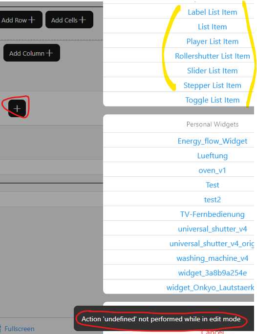

  1. I’m not able to add List Items to a new List Card.
    If I klick on the “+” Icon of the new List Card, the options appear but an error is shown:
    ”Action ‘undefined’ not performed while in edit mode”. This is unexpected in my opinion.
    If I click on a List Item to add it, the menu disapear as expected, but no Item is added.

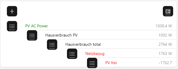

  3. Text Color Settings (Style) are not applied to the Item Value anymore, only to title.
  4. Existing List-Card Items are not displayed one below the other anymore in edit mode. In “Run Mode” the arrangement is correct, but colors still only on titles not on item values.

I observed the same behavior and see what @florian-h05 answered:
simple list

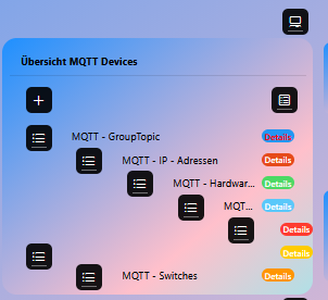

I have the same problem with a listcard-widget in edit-mode:
The Yaml-Code looks like:
component: oh-list-card
  noBorder: true
  noChevron: true
  noHairlinesBetween: true
  noShadow: true
  outline: true
  style:
    --cardCorners: 20px 20px 20px 20px
    --cardHigh: auto
    --cardWidth: auto
    --f7-card-box-shadow: none
    background: linear-gradient(to top left,green 0%,lightblue 60%)
    border-radius: '=(props.corners) ? props.corners : "var(--cardCorners)"'
    font-size: 20px
    height: auto
    margin: 5px
    noShadow: true
    padding: 10px
  stylesheet: |
    .card-header {
      background: transparent
    .card-content {
  title: Übersicht MQTT Devices
  default:
    - component: oh-list-item
        action: group
        actionGroupPopupItem: gGrTop
        badge: Details
        badgeColor: blue
        style:
          --f7-badge-text-color: red
        title: MQTT - GroupTopic
        action: group
        actionGroupPopupItem: gIpAd
        badge: Details
        badgeColor: ocker
        title: MQTT - IP - Adressen
        action: group
        actionGroupPopupItem: gHard
        badge: Details
        badgeColor: green
        title: MQTT - Hardware Processors
        action: group
        actionGroupPopupItem: gVer
        badge: Details
        badgeColor: lightblue
        title: ='MQTT - Firmware Version '
        action: group
        actionGroupPopupItem: gSSId
        badge: Details
        badgeColor: red
        textColor: teal
        title: MQTT - WLAN
        action: group
        actionGroupPopupItem: gLWT
        badge: Details
        badgeColor: yellow
        title: MQTT - LWT
        action: group
        actionGroupPopupItem: gT_OnOff
        badge: Details
        badgeColor: orange
        title: MQTT - Switches
I tried this with a test-system openHAB 5.2.0-SNAPSHOT - Build #5063
Cheers - Peter
I don’t think that’s a good idea for the same reason it’s not a good idea to have a red warning light lit right next to your oil lamp. When another warning appears, one that you should react to, you probably won’t. So, if just “accepting” them should be the solution, there must be some way to mute selected.
These are two bugs that actually aren’t linked to each other. The error can be ignored.
You can work around the bug that no children can be added by manually addding slots: {} to the empty list item in the code tab.
I will provide fixes for those bugs.
I’ve tried restoring the old behaviour, but that’s not easily possible without introducing other issues. I’d suggest to simply add --f7-list-item-after-text-color: yellow to the style of the oh-*_item.
Will fix those.
See oh-list: Fix various issues when editing by florian-h05 · Pull Request #3741 · openhab/openhab-webui · GitHub.

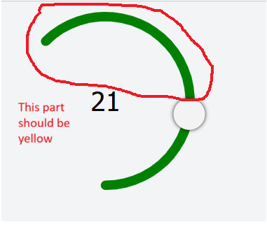

Hey Guys,
since 5.1 the rangeColor parameter of the oh-knob component doesn’t work anymore. Below you find an example YAML-Code for a basic Knob-Widget and a screenshot of the result:
uid: widget_cea0032661
props:
  parameterGroups: []
  parameters:
    - name: prop1
      label: Prop 1
      type: TEXT
      description: A text prop
    - name: item
      label: Item
      type: TEXT
      context: item
      description: An item to control
tags: []
component: oh-knob
  borderWidth: 0
  endAngle: 270
  handleShape: round
  handleSize: 30
  item: raumklima_diele_Set_Point_Temperature
  lineCap: round
  max: 30
  min: 5
  pathColor: green
  rangeColor: yellow
  readOnly: false
  releaseOnly: true
  showTooltip: true
  startAngle: 45
  step: 0.5
  strokeWidth: 9
  tooltipColor: black
Is this a known issue?
We now have both 5.1.0 and 5.1.1 - which version are you having this problem with?
