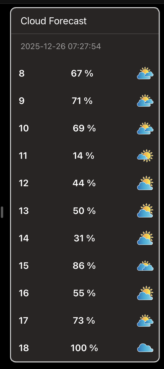

Hi Team
Great new release thanks for all the hard work by everyone
System:
Hardware: Openhabian on Raspberry Pi 8GB Ram
Upgrade from 4.3.9
Issue: Main UI Widget does not display correctly
I have a Custom Widget that worked under 4.3.x and before

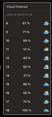

When I am in the widget editor the widget displays correctly. (Image 1)

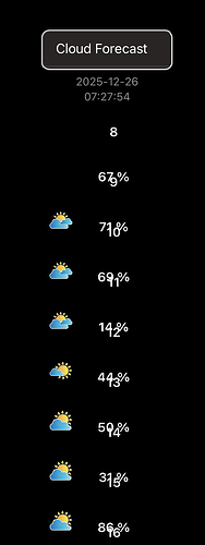

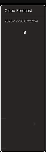

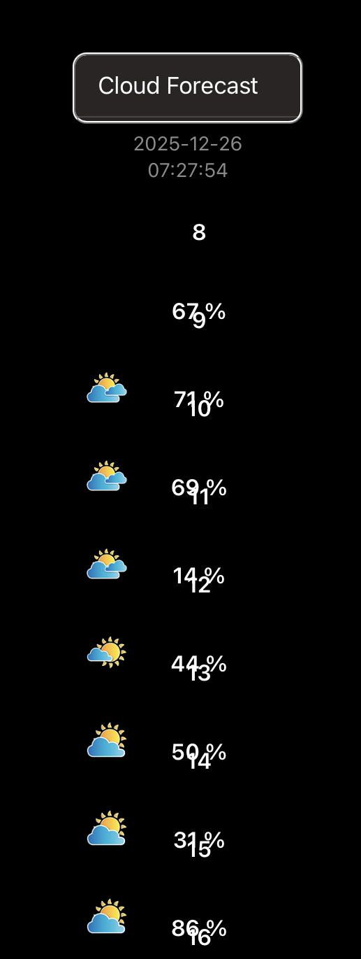

When the widget is displayed as intended on a Page the widget fails to display correctly (Image 2)
If i place the image on a page page and reduce the height of the image the widget shows some of the text but incorrectly:(Image 3) In image 3 the box at the top is the size of the widget now
What the widget does : retrieves items from a custom HTTP Thing and display cloud levels for each hour of the day) Additionaly the text in the row of the currently hour should display in read (side note: the rows before the current hour are the cloud cover for the next day
Browsers tested:(Same results)
Safari on IOS 26 (iPad)
Safari on Mac OS
Chrome on Mac OS
Openhab App 3.1.41(98) on IOS
Images:
Image 1:
Image 2:
Image 3:
The Widget:
