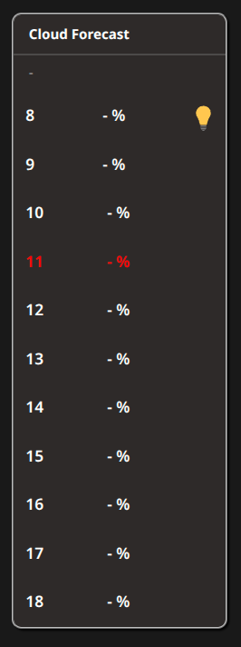

I cannot reproduce the issue, neither on Chromium 143 on Linux nor on Safari on iOS 26.2:
(I displayed a lightbulb icon to see where the icon renders.)

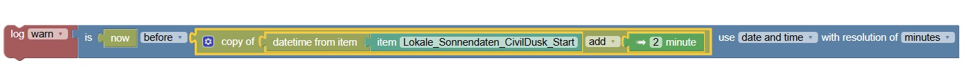

After upgrading to 5.1 Release blockly is braking some of my rules.
it is this block
Screenshot 2025-12-26 111946
creating this code with 4.3.8 Release
(time.toZDT('2025-12-26')).plusMinutes(2);

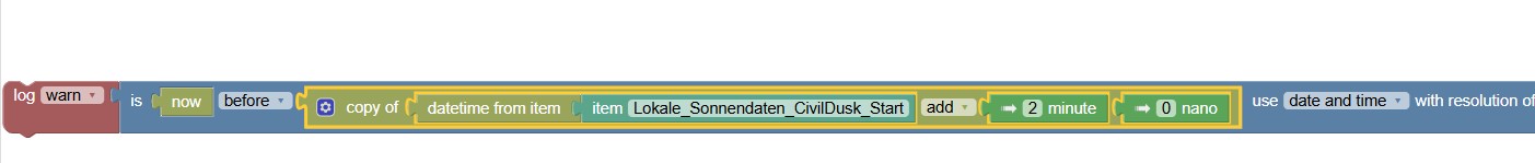

the same block is creating this code with 5.1. Release
(time.toZDT('2025-12-26')).plusMinutes(2).plusNanos();
console.warn((zdtCompare((time.ZonedDateTime.now()), (time.toZDT(items.getItem('Lokale_Sonnendaten_CivilDusk_Start'))).plusMinutes(2).plusNanos(), 'before', 'minutes', 'dateandtime')));
creating this ERROR Code
Level
ERROR
Logger Class
org.openhab.core.automation.module.script.internal.handler.AbstractScriptModuleHandler
Message
Script execution of rule with UID 'Test2' failed: DateTimeException: Invalid value for NanoOfDay (valid values 0 - 86399999999999): NaN in @openhab-globals.js at line number 2 at column number 72736
As a workaround i usea second temporal unit with nanos
creating this code
console.warn((zdtCompare((time.ZonedDateTime.now()), (time.toZDT(items.getItem('Lokale_Sonnendaten_CivilDusk_Start'))).plusMinutes(2).plusNanos(((time.toZDT(items.getItem('Lokale_Sonnendaten_CivilDusk_Start'))).get(time.ChronoField.NANO_OF_SECOND) / 1000000 | 0) * 1000000  + (((time.toZDT(items.getItem('Lokale_Sonnendaten_CivilDusk_Start'))).get(time.ChronoField.NANO_OF_SECOND) / 1000) % 1000 | 0) * 1000 + 0), 'before', 'minutes', 'dateandtime')));

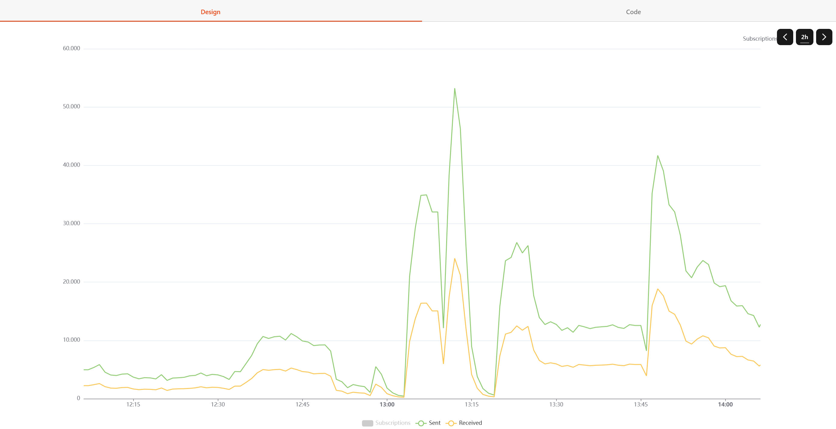

I have de-activated all the rules and scripts (Blockley) where I was using the MQTT-Library. Then I re-created the Docker Container.
Now in the OpenHab debug logs for MQTT I can see, that someone in OpenHab is still sending 10.000nds of MQTT messages (no rules active…). I am really wondering why the sytem is sending them at all - and why so many? Maybe a confusion with JS Library and MQTT-Blockly AddOn?
Normaly I have a few 1000 Messages, now you can see the OpenHab re-starts and tests, there are now 50.000 messages which is polluting the Zigbee Network…
Update: I just removed the MQTT-Library for Blockly and re-started → but nothing changed, someone is still sending all the messages.

But the phenomenon i had with postCommand:true, which i initially described as a kind of flickering, was nothing else than a loop, caused by the wrong MQTT setting, which can generate a mass of MQTT messages within a short time. My feeling is, that you might also have such a loop as root cause for your problem. The standard setup for MQTT channels should be postCommand:false.
Yes - that was the problem! Thanks so much…
I understood the first post wrong, so I verified earlier that in all my MQTT-commands the ‘postCommand:true’ is configured. Now I set all of then (even the ones that are posting MQTT messages) to false. And with this the message-flooding disappeared.
In general I am now wondering what this setting is good for? Because even if it is set to ‘false’ the MQTT-update is still sent…
Again - thanks so much for the tip, I assumed something deep inside with a JS-setting / bug or similar… I would have never found this one…
