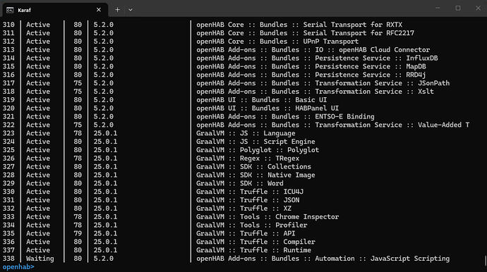

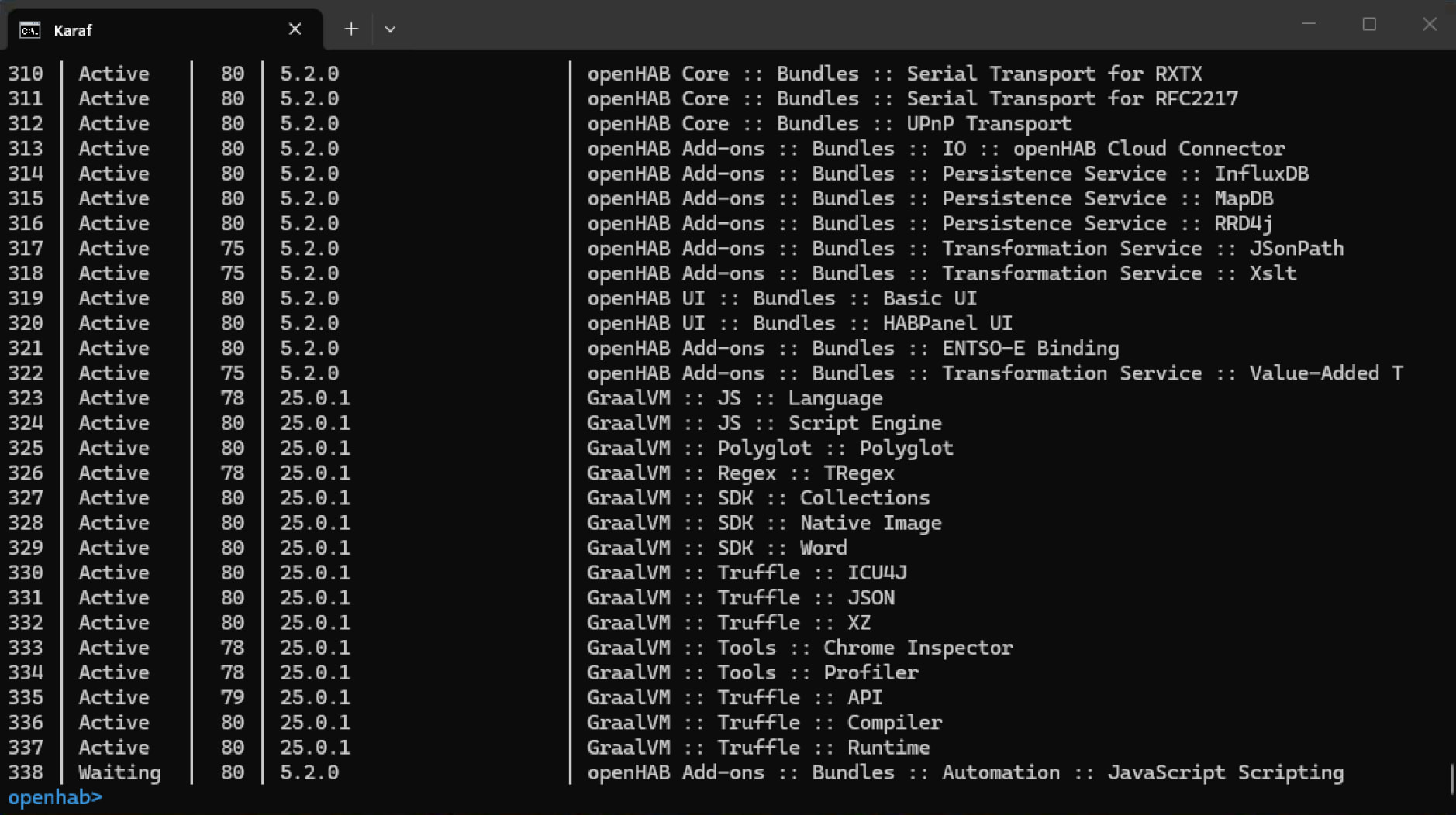

I have now some problems with Javascript scripting addon because it’s status seems to be ā€œwaitingā€ and it still has the same status when I type command
bundle:restart 338
This problem affects the Entsoe binding because my ECMA script transformation is not working (see discussion Entsoe Binding - #31 by jlikonen).
I have tried to uninstall JavaScript Scripting addon and reinstall it but this hasn’t helped.
Below is a copy extracted from the log-file:
2026-07-27 07:34:34.706 [ERROR] [.internal.GraalJSScriptEngineFactory] - bundle org.openhab.automation.jsscripting:5.2.0 (338)[org.openhab.automation.jsscripting.internal.GraalJSScriptEngineFactory(463)] : Error during instantiation of the implementation object

Any ideas?
Looks like a download issue.
Can you install the openhab-addons package if you are on Linux package install?
I’m running OH5.2 under Win11 box, not under Linux. I copied the kar file to addons folder and restarted OH but the status of the JavaScript Scripting addon is still ā€œwaitingā€.
I managed to sort out this problem by reinstalling OH5.2.0.

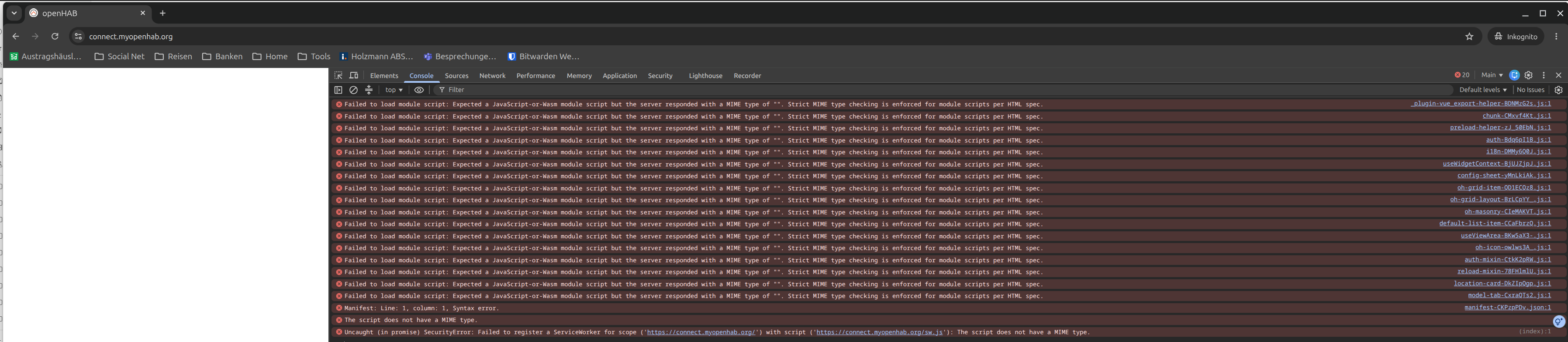

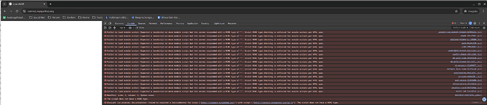

After upgrading from openHAB 5.1.3 to 5.2.0 I have a reproducible problem with the MainUI when accessing it via myopenHAB.
Findings:
  • Local MainUI (http://<local-ip>:8080/overview/) works perfectly.
  • MainUI via connect.myopenhab.org often shows a blank page (sometimes partially rendered).
  • Sitemaps via myopenHAB work.
  • Push notifications work.
  • The failing JavaScript module changes on every reload.
  • Browser console reports:
    Failed to load module script:
    Expected a JavaScript module script but the server responded with a
    MIME type of ā€œā€.

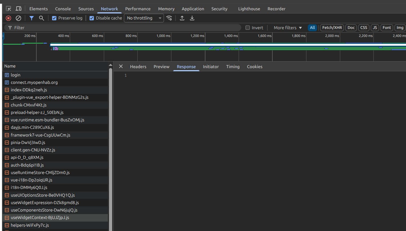

Looking into Chrome DevTools shows:
  • HTTP 200 OK
  • empty response body (~0.3 kB transferred)
  • no Content-Type header on the failing requests
  • Transfer-Encoding: chunked
  • disabling browser cache and disabling the Service Worker makes no difference.
Has anyone seen this after upgrading to 5.2.0, or is there anything else I could check?
