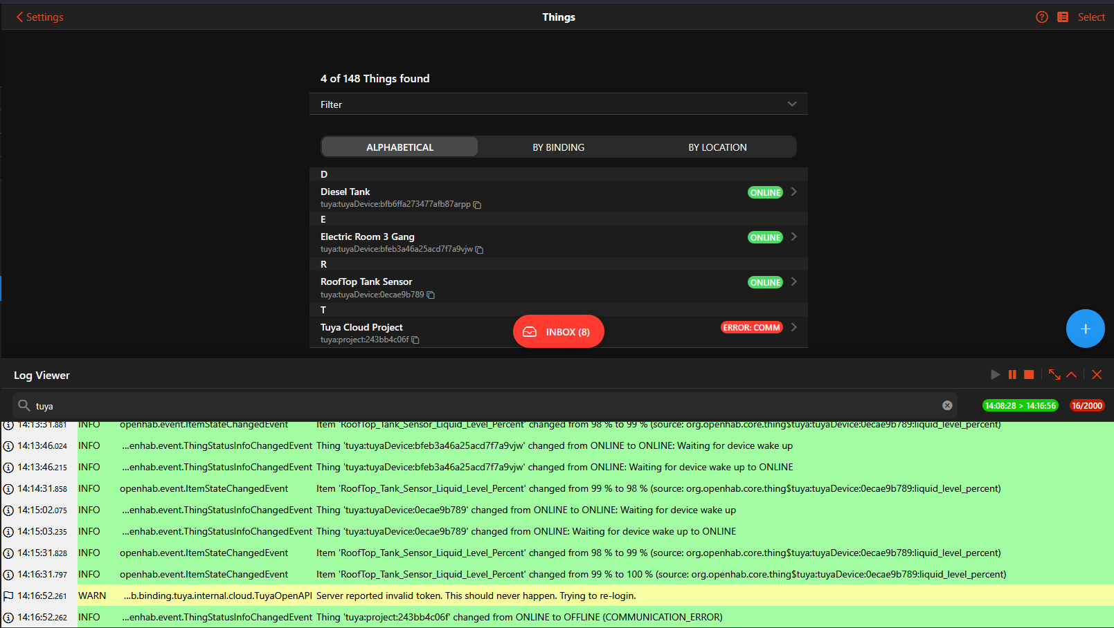

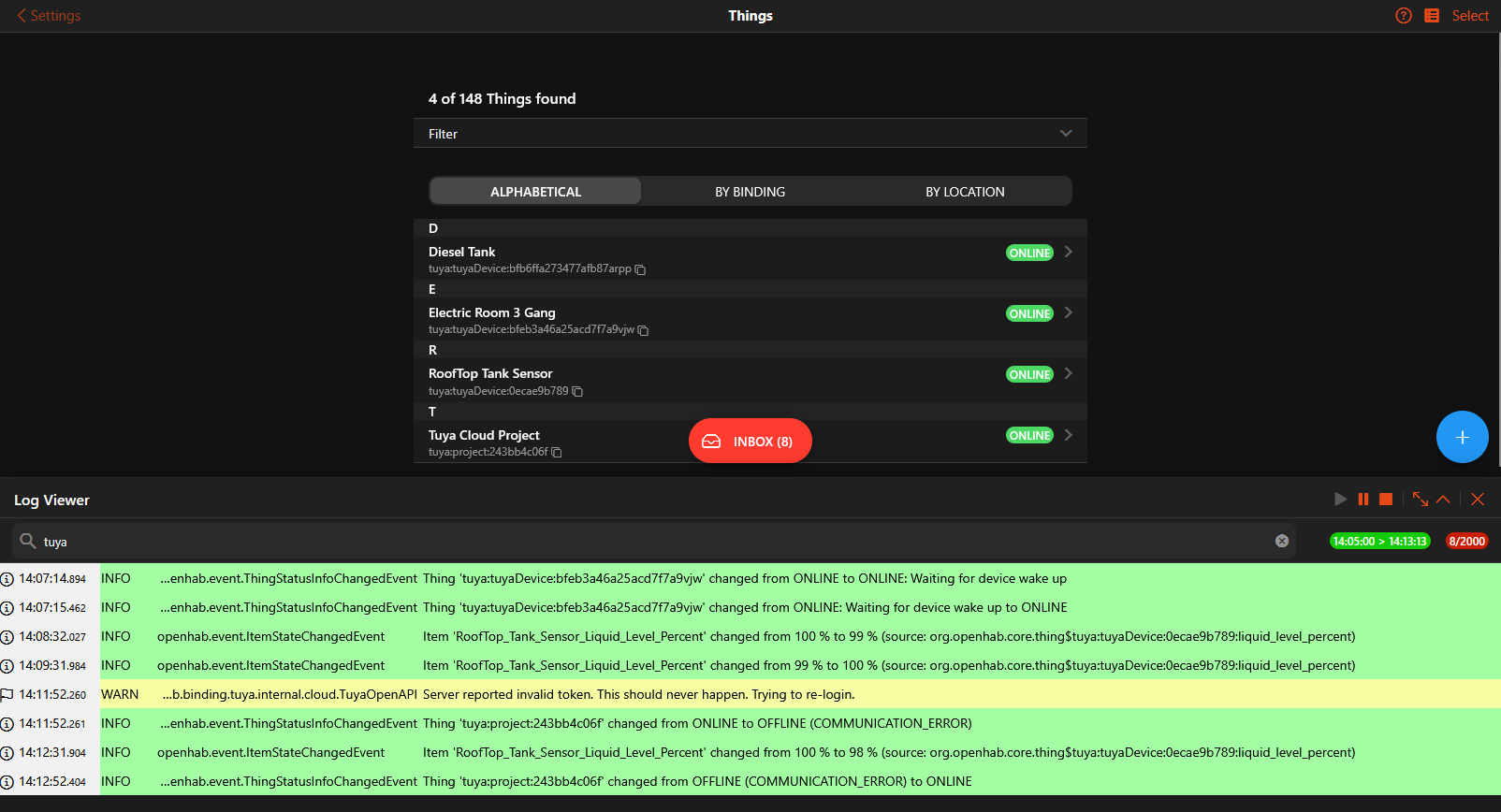

I have been testing for the last couple of days, and I am happy to report that 5.2 is behaving very well. All the scripts/rules, widgets, and addons are working perfectly.

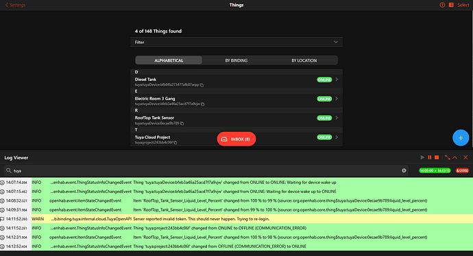

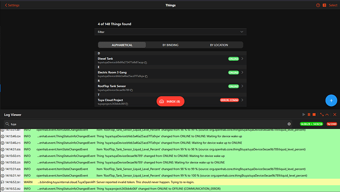

The only issue is again with the Tuya binding. The cloud project connects and then disconnects again (around every 5 minutes). The sensor, though, once online, is sending updates nevertheless (which is good).
The cloud project gives an invalid token error
but then comes up again and sensor data is flowing. debug logs not showing beyond what is shared.
I looked into the ports. The tuya items as opposed to the binding have not the ports exposed. I checked other bindings/items there is not conflict. Changing the default port actually disconnects the connection to the items. Noting this worked perfectly on 5.1.1 with the ports fixed to the default.
How can I continue debugging the binding (maybe not on this forum) so we get the fix in the next release?

Issue created here [Tuya] Tuya Cloud Project Item on 5.2.0 Disconnects and Connects With "Invalid token error" · Issue #21218 · openhab/openhab-addons · GitHub

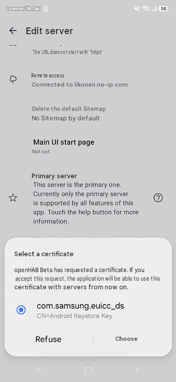

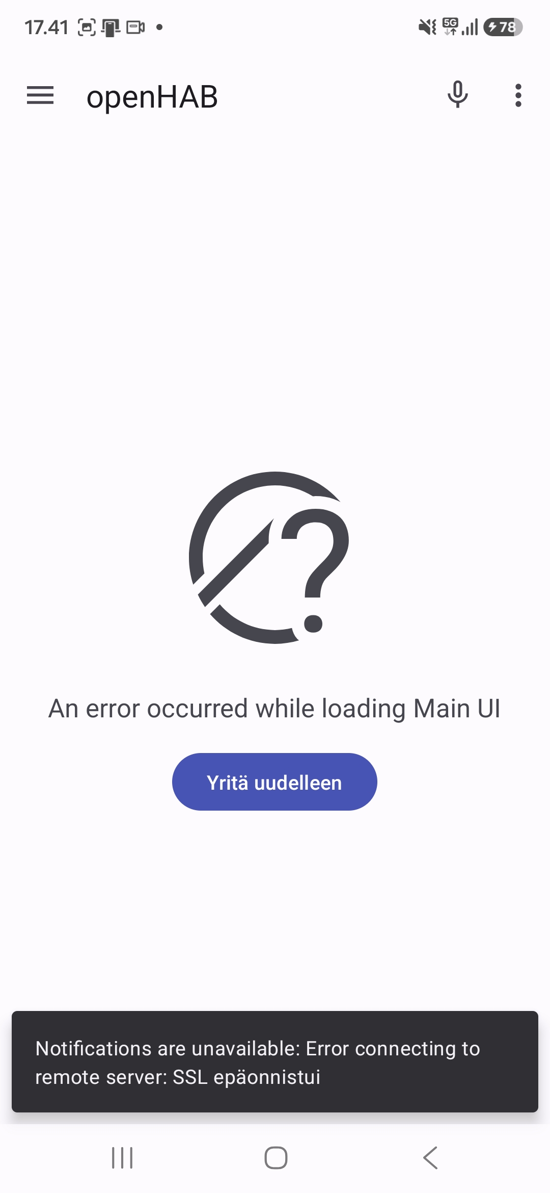

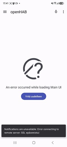

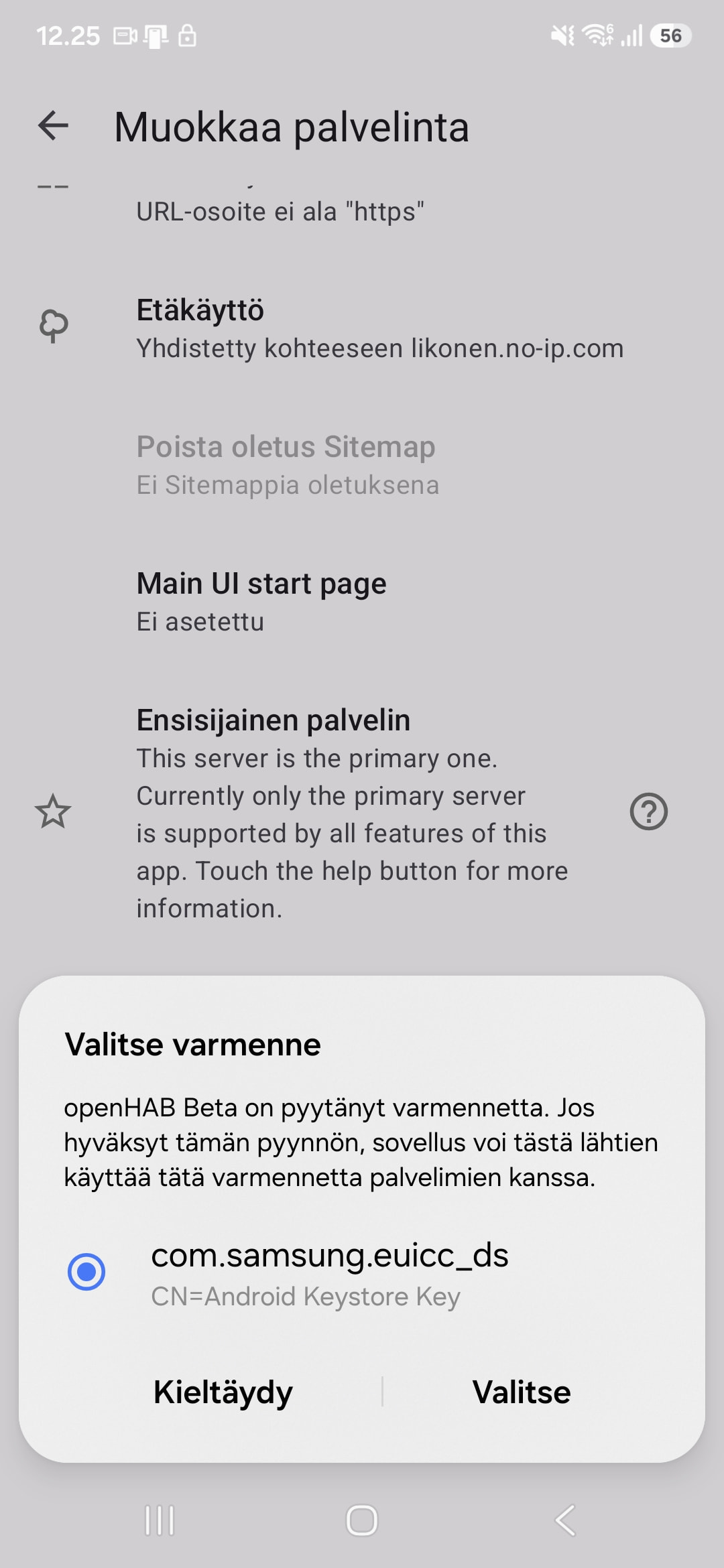

I upgraded today my OH from 5.1.3 to 5.2.0 and now I’m having some problems with the android app. I can connect to OH5.2 without any issues when my phone is connected to our internal wifi but when I try to connect e.g. from a mobile network I get an SSL error.
I have also tried to use the certificate which the android app proposes (com.samsung.euicc_ds) but this doesn’t help.
I have used URL https://xxx.no-ip.com:10000 since OH3 without any issues but this doesn’t seem to work under OH5.2.

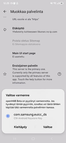

Can you expand on this part, specifically on how the app supposedly proposes a certificate? I don’t think it actually does that.
Below is a screen copy of the app. I’m not sure if the app really proposes a certificate. Unfortunately the text is mainly in Finnish.
Google translated:

I’m not entirely sure, but I guess what happens there is that myOH offers client certificate authentication, and your phone subsequently asks you to choose a certificate for doing so, but the only available certificate is the eSIM one. Does choosing cancel on that dialog get you further?
Nope, after clicking cancel I get the same error message as in my first post. Something wrong with SSL.
