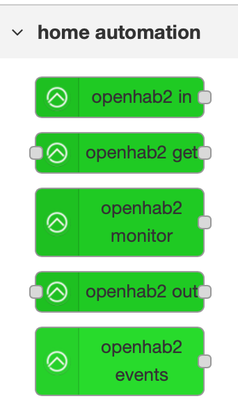

At the very bottom of the left column you’ll see these items:
You’ll want to drag one of the first (openhab2 in) over to the grid on the right.

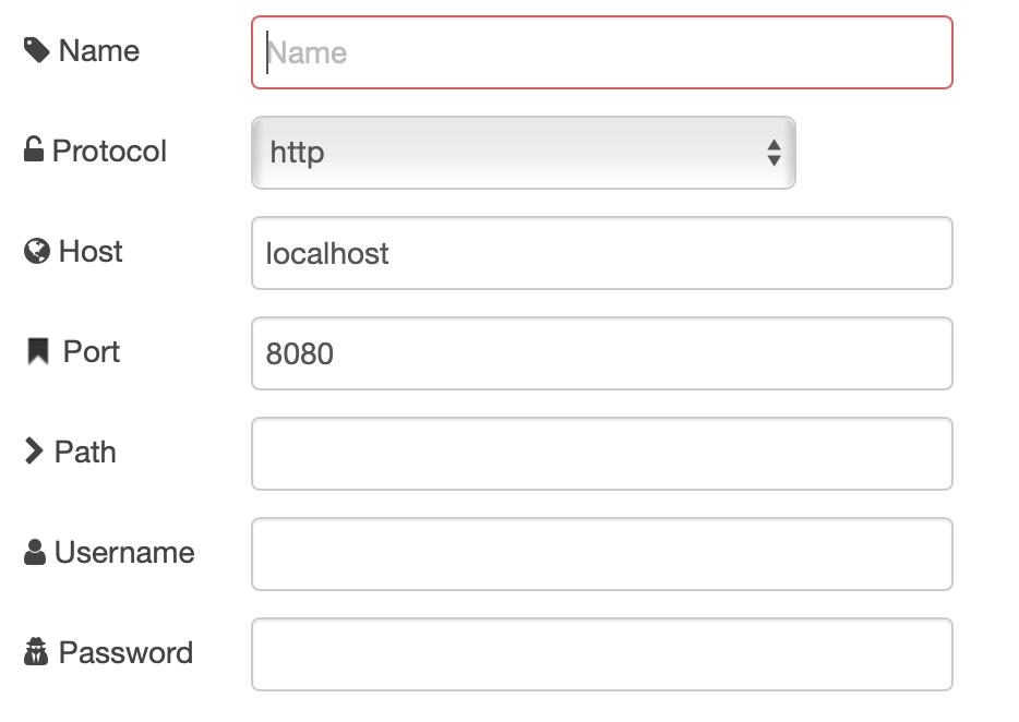

Double-click that guy and you will see a drop-down with “add new openhab2 controller” go ahead and click the pencil just to the right of that drop down.
This is my setup, yours should be identical since you’re running openhabian.
Click “add”

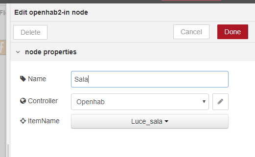

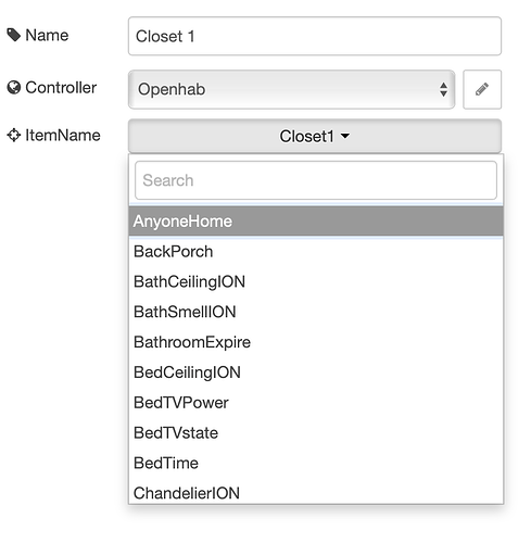

Step 3: link that node to any openhab item:
You can choose whichever item you like. All state updates will “come out” of it. go ahead and choose one and save it

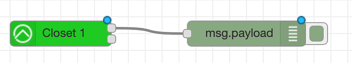

Step 4: drag in a “debug”
And drag a wire across just like this.
Step 5: click “deploy”
And watch the debug tab on the right - as you change whichever item you choose, the state updates should show up in the debug panel.

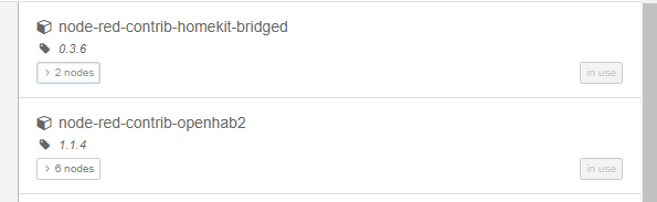

…in the manage pallette i only can see the node-red-contrib-openhab2.
the homekit-bridged node is missing…
You’ll have to add that one - there are 2 tabs at the top of the pallette manager one showing “nodes” and one showing “install”
Use the install one to search for and install the homekit.

…installed

Modify items Openhab ( modify in e out)
Modify node HomeKit

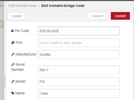

Once everything is installed and the nodes are created and modified, press desploy.
Go to Home is configure the new bridge
