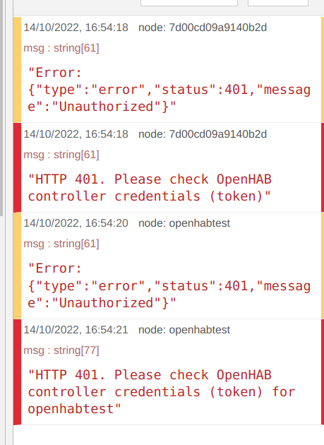

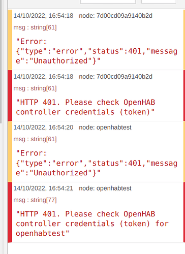

I’ve seen a version for OH3 has been updated last week, it says “check credentials” but with these credentials I can access the web pages of OH.

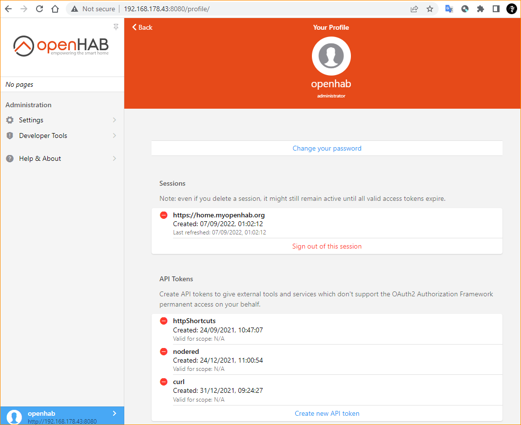

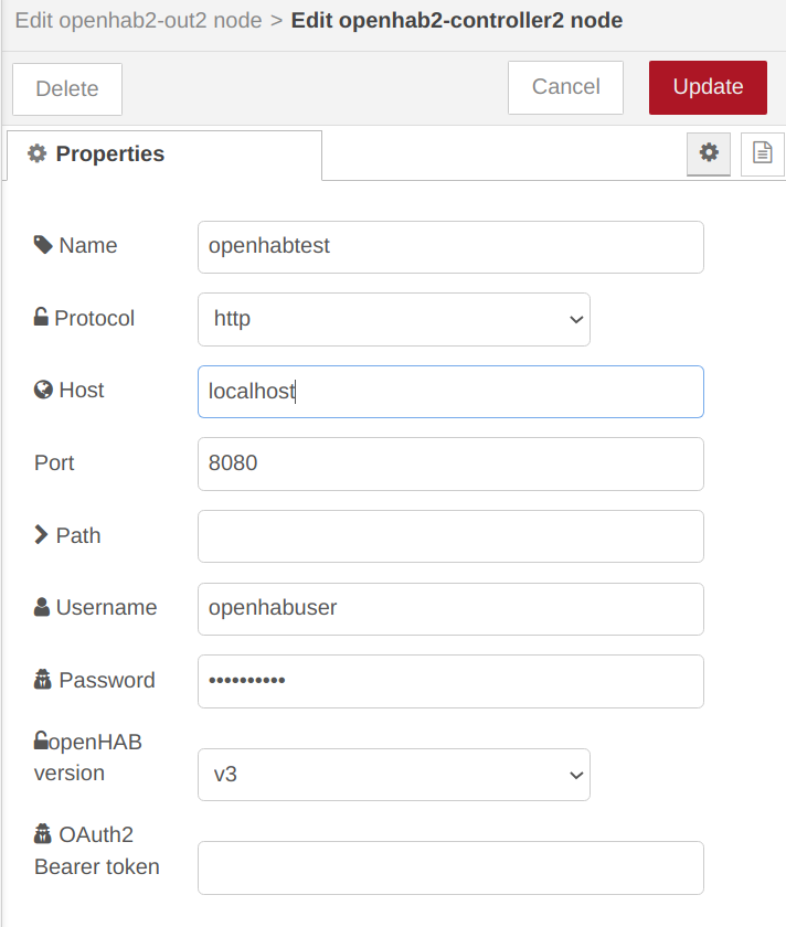

I haven’t had to edit anything like this for a while, but I think you’ll find that creating an API token is the easiest solutions, so that your Node-RED openHAB controller configuration looks something like this —
You can create a new token from the homepage of your openHAB instance.
Click on the bottom left hand corner, to find something like this
Then click on “Create new API token” at the bottom.
You should be able to follow the pop-ups from there.
Just past the API token into Node-RED and REMOVE the username and password that you have currently.
