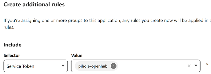

Hey There, i just wanted to show my .things file and steps i took for an application behind Cloudflare Zero trust which i access via http binding.
At first i created the tunnel, the application, followed by a service Token and a rule for that app:
So i figured out how to use it with curl:
curl "https://pihole.domain.tld/admin/api.php?summary&auth=<Pihole-APIKEY>" -H "CF-Access-Client-Id: <Client ID>" -H "CF-Access-Client-Secret: <Client Secret>"
