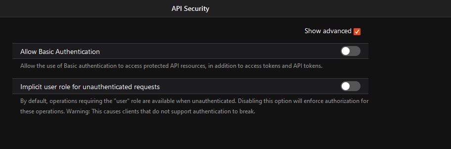

I see that if I enable in API “Implicit user role for unauthenticated requests” that access over cloud work. But my server in that case is not secured and everyone can without login access over API to items/sites and that is not option.

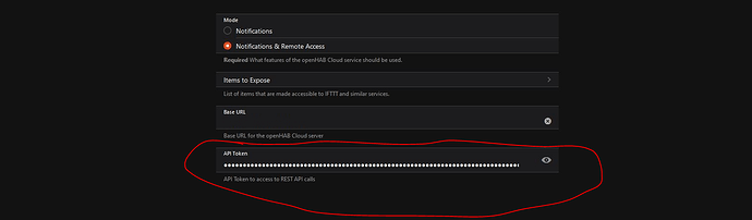

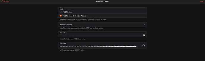

 Im check cloud addon source code, setup VSCode IDE and add new API token authentication into Cloud addon.
Right now I testing addon and looks like it work as must.
Both option can be disabled and it normally work ONLY over cloud connection.
Because Android app do not support API Token authentication it do not connect localy. To use also local connetion in API settings “Allow Basic Authentication” must be enabled. Then it work like this:
Local connection use basic authentication which is supported by android app
Remote connection use basic authentication to connect to Cloud server but then addon localy use API key to authenticate to openhab server.
That way you can have disabled “Implicit user role for unauthenticated requests” and prevent everyone in your local network to control your openhab server
Now I need fix implementation of sendNotification() functions to get it work on OH3 and then if someone is interested to try/test it I can send jar file
