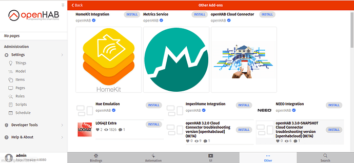

UPDATE: I have now published the addon in the marketplace, to allow even more easy installation (and further updates)
You can find them from the MainUI marketplace view with “cloud connector troubleshooting version” keyword. Direct links for marketplace forum posts: openHAB 3.2.0 version and openHAB 3.3.0-SNAPSHOT version.
That’s awesome. I uninstalled the other test bindings I used, restarted openhab and installed the 3.3.0-SNAPSHOT troubleshooting version from the marketplace. Everything seems to work fine, and I will be testing this configuration now and report back if the connection problem can be reproduced again.
