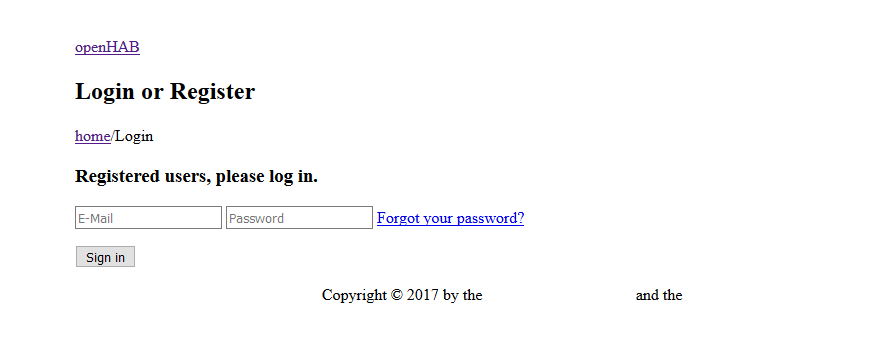

Location directives in the nginx config file are in the form of /opt/openhabcloud and your openHAB cloud folder is /opt/openhab-cloud. I think the dash could be the problem.
Matthias, right on the spot, thank you for your reply! This indeed fixed the problem:
sudo vi /etc/nginx/sites-available/default
Occurrences of alias /opt/openhabcloud/... replaced with alias /opt/openhab-cloud/...
sudo service nginx restart
The static content now loads fine:

This this completed I started openHAB-cloud
10. Starting openHAB Cloud
For this I just did the following command and received general warnings.
sudo node app.js
After running this command and waiting a few seconds I was able to see the openHAB Cloud log in page when I sent to my domain. I also used pm2 to run the openHAB Cloud

Conclusion
This resulted in me having a openHAB Cloud server that I can see on my domain. I haven’t tried to configure it to a openHAB client yet but that will be my next step.
