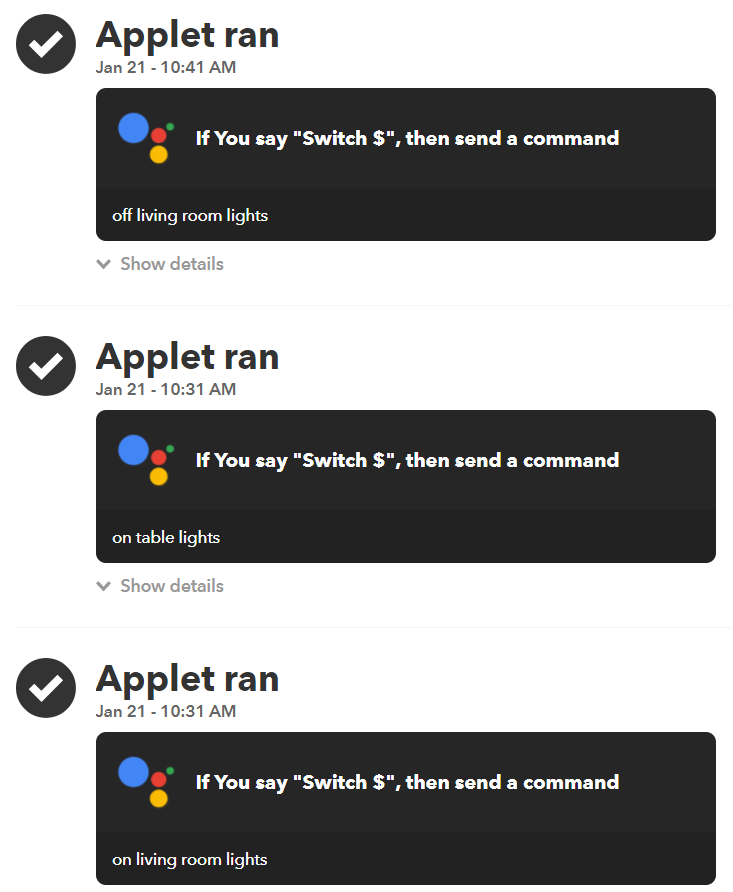

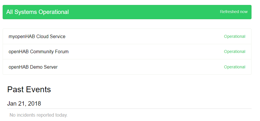

I have some issues with myopenhab , at first I thought it was me, especially as the status page say this.
But from this activity on IFTTT (see the command at 1041) :

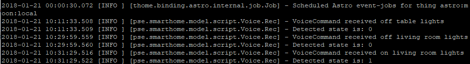

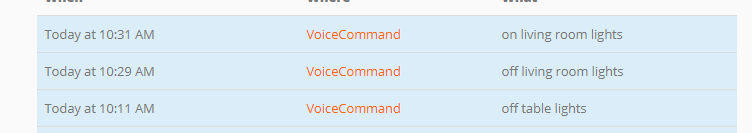

And this (logginf from my server and events from myopenhab, the 10:41 command is missing):
I concluded that it can’t be me if messages get lost between IFTT and myopenhab.
This is not a one time thing, just using this one as an example.
Yet the status page says everything is working fine… No announcement in the forum either.
