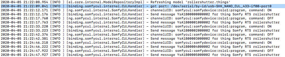

it looks like its sending something, i´ve followed the steps from Daniel:
The installation worked for me as follows:
1. Install the binding into your OpenHab installation (see Distributing bindings through the IoT Marketplace )
2. Add the appropriate things to your config (.things)*
* *somfycul:culdevice:cul [ port="/dev/ttyACM0" ]* *somfycul:somfydevice:esslinks (somfycul:culdevice:cul)* *
3. Add a rollershutter as a switch to your sitemap for programming the switch (.items and .sitemap)
* *Switch Shutter_Ess_Links "Eßzimmer links" (somfyFF) {channel="somfycul:somfydevice:esslinks:program"} * *
4. Set the rollershutter to programming mode via your remote (should go up and down slightly)
5. Press the switch in your sitemap (the rollershutter should go up and down slightly for confirmation)
6. Change the rollershutter in your items and sitemap to a rollershutter :wink:
* *Rollershutter Shutter_Ess_Links "Eßzimmer links" (somfyFF) {channel="somfycul:somfydevice:esslinks:position"} * *
This is how I set up all my rollershutters in my house now via a CUL.
but my rts blinds do not react.

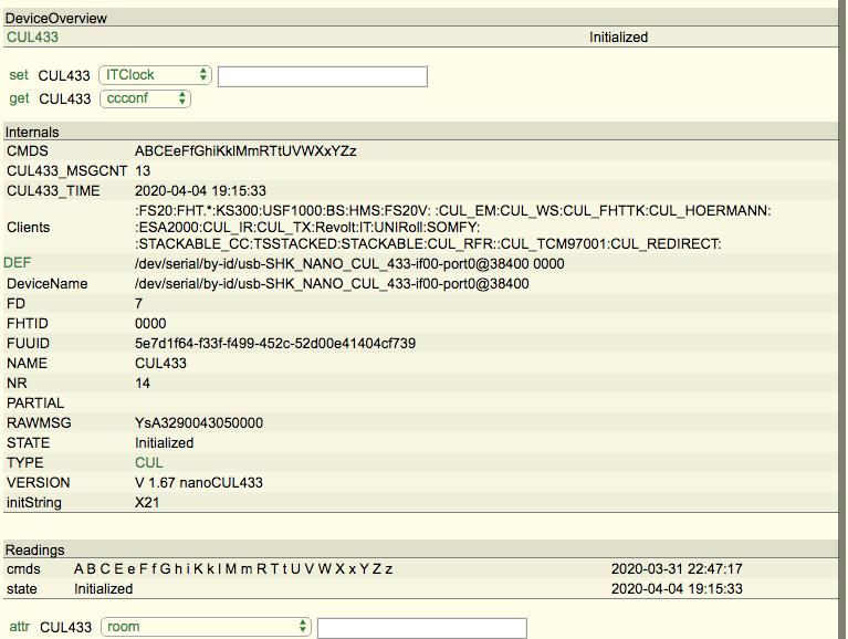

The first try that I did in order to find out if the stick works with the appropriate CUL firmware and command set (culfw reference) before trying my Java test program (and then continuing with OpenHAB development) was to simply check via serial connection if I can access the CUL stick and get some information. As I have a linux installation I used the appropriate command line tools.
So connect to the serial port and then issue a simple command
screen /dev/ttyACM0
and then issue
V
for printing the version of the CUL firmware.
After that I used the values from the FHEM installation for the address, rolling code and encryption key (see FHEM reference) and put those in the Java test program (serial-cul-test/src/main/java/de/danielweisser/home/SomfyCULTest.java at master · weisserd/serial-cul-test · GitHub) in order to see if I could reuse the already learned FHEM remote to control the shutter.
When that worked I used to learn a new Java remote that I then reused for further experiments.

I checked the cul firmware version issuing ‘V’ :
‘3.3.1 SIGNALduino cc1101 (chip CC110 unknown) - compiled at Dec 3 2019 19:40:46’
CC1101 should offer a frequency switch from 433.92 MHz to 433.42 MHz, but I did not find the command for that.
My cul was delivered with a-cul FW 1.26.08 and I flashed it to SIGNALduino because it did not work with this FW as well.
I’m now using binding ‘org.openhab.binding.somfycul-2.5.1-SNAPSHOT.jar’
→ No success with openHAB.

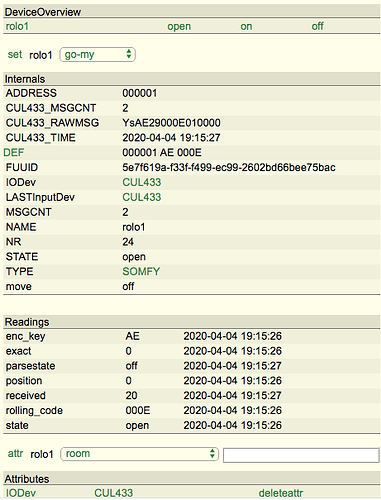

Controlling the shutters with FHEM I observed in the logs that the lower nibble of the encryption key is not fix but always corresponds to the lowest nibble of the rolling code. I don’t know whether this is important.
Again I’m out of ideas how to proceed.
