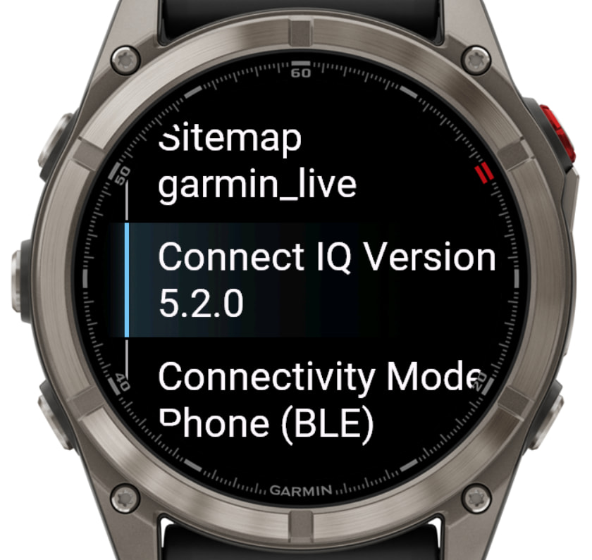

The latest v1.2.0-beta2 also adds an entry to the settings menu in the openHAB app on the watch where you can confirm that the latest firmware actually supports CIQ 6.0.0. See the screenshot below, which still shows the older version.
Sure, loaded your sitemap with no problem. Navigation works well with touch and button. What should I look for?
Sending commands cause c:404 error as mentioned but back button or screen touch slide work here fine as wellness.
My firmware: 21.30
CIQ 6.0.0
Great, thanks, that is exactly what I needed. The issue I was looking for would have appeared immediately on startup, showing a full-screen -402 error because the JSON response was too large.
It seems that, for reasons unknown, Garmin introduced a lower size limit in the latest SDK and simulator. There was some speculation that this might be preparation for a lower limit being rolled out with CIQ 6.
Based on your test, however, it looks like we are in the clear. CIQ 6 devices can still process larger JSON responses.
