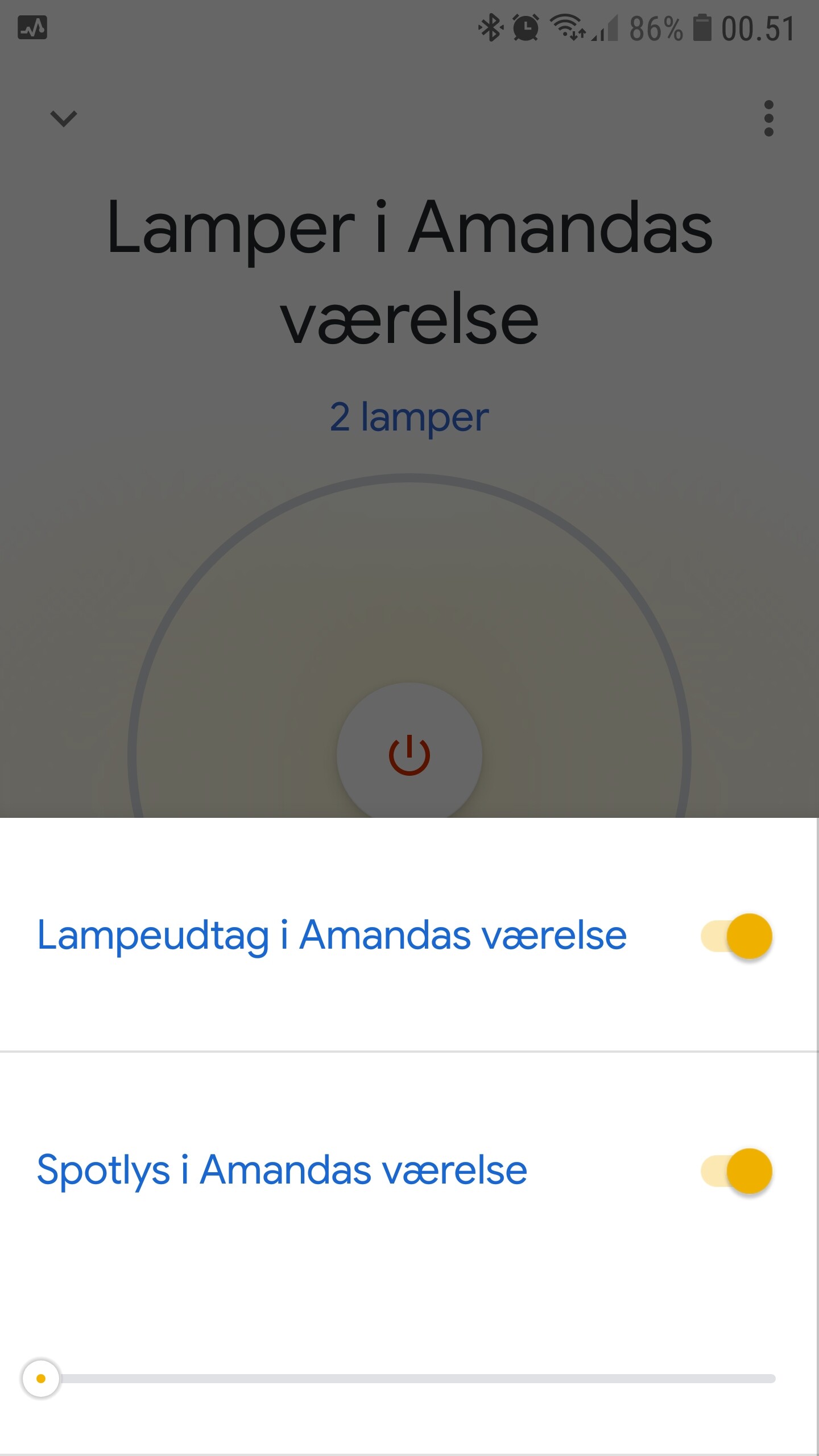

The Android app have problems as well. When I enter a dimmer (light) it always show 0, even though the dimmer is on at 30% or anything else.
Look at this.. The bottom lamp is one of my IHC dimmers. It´s actually turn on at 30% right now. But the app shows 0.

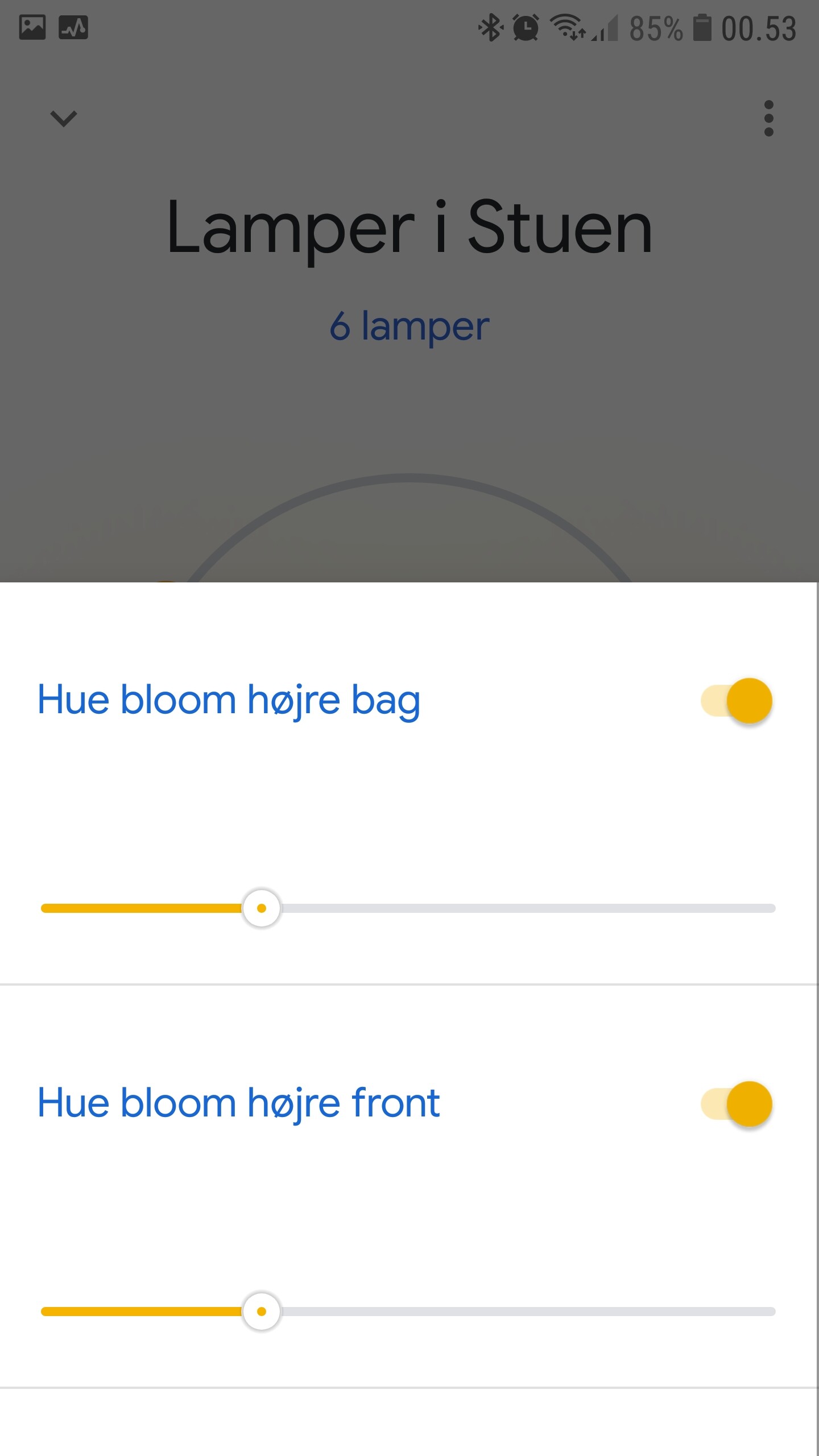

This next screenshot is from my livingroom where I have Hue lamps.. Notice, it DO show their actual state:
For some reason is seems like devices tagged through openhab does not update correctly. But devices added directly to Google Home service (such as Hue) updates just fine.

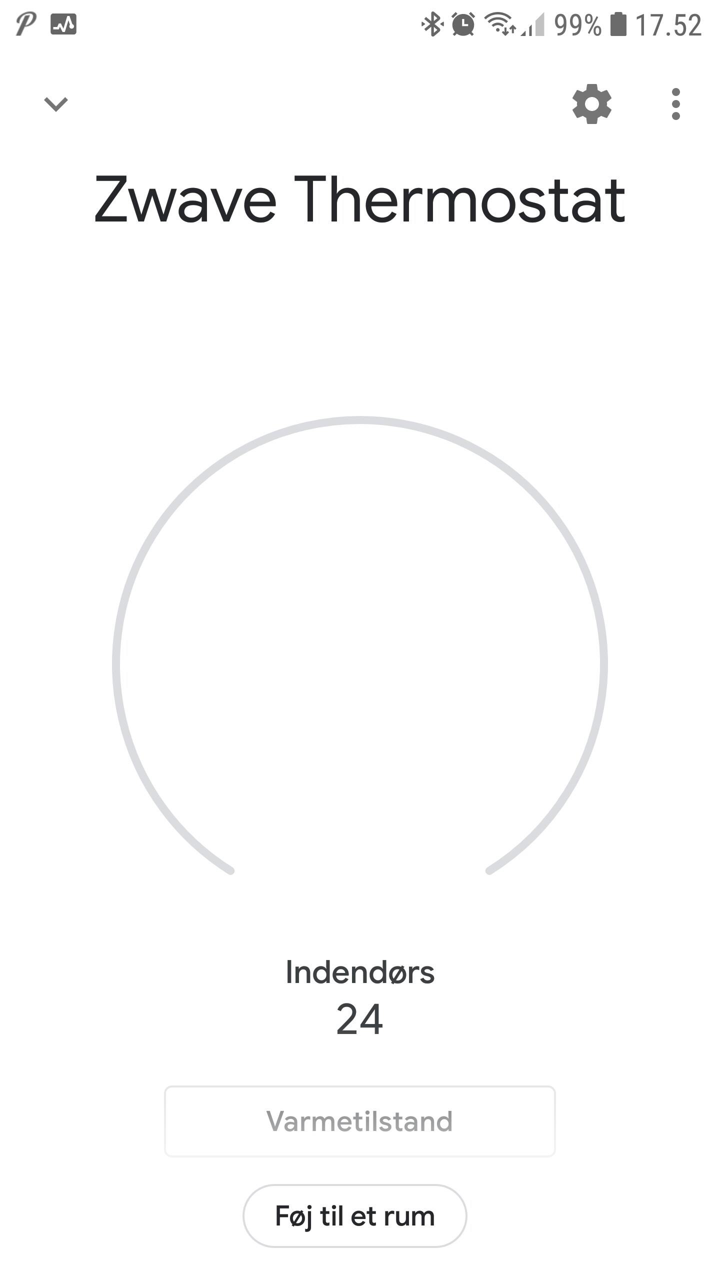

I have a single test temperature sensor running. (Aeotech Mutilsensor6).
I have the group tagged [ “Thermostat” ] and then just the temperature sensor item [ “CurrentTemperature” ].
(I do have the targetHeatingCoolingMode as well, but it doesnt work. And it doesnt make any sense having either, as this is not a thermostat (not even functioning as a thermostat)). I just added the String item to see what will happen. ie.. nothing!
Group     g_zwave_TSTAT                                   "Zwave Thermostat"                                                                        [ "Thermostat" ]
String    ZwaveThermostatMode                             "Zwave thermostat Mode [%s]"                                (g_zwave_TSTAT)               [ "homekit:TargetHeatingCoolingMode" ]
Number    ZWaveNode5ZW100MultiSensor6_SensorTemperature   "Multisensor6 Temperatur Sensor [%.1f °C]"   <cu_heating>   (Temperatur,g_zwave_TSTAT)    [ "CurrentTemperature" ]   {channel="zwave:device:zstick:node5:sensor_temperature"}
This is how it poses in GH app:
Notice is say 24 under the wheel. Thats the actual temperature from the sensor right now.
So a simple setup just showing the actual temperature should work just fine.
The wheel is grey out cause I have not set the setpoint.
The heatingcooling mode (where is says “Varmetilstand”) is grey out, cause I havn´t set the targetHeatingCoolingMode.
