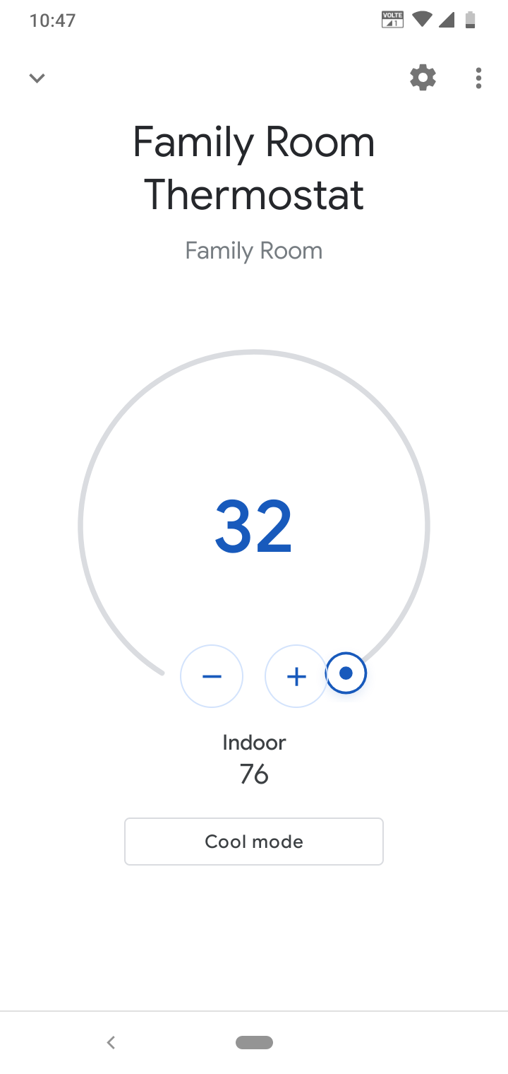

That did it! It looks normal now with temp showing, albeit at 32, and all the other controls, buttons, etc. What does that mean then?
I believe there is a fatal bug in the latest release of the GA integration where “Fahrenheit” used in the Thermostat tag seems to breake the thermostat.
Lets wait an see what Dustin come up with. If he experience the same, we´ll have to notify Michael Krug, (file an issue on github).
Now you had “Fahrenheit” in your thermostat, and now it´s removed.. Does you´re temperature still show the same value in Fahrenheit, or is it celcius now?
I believe it’s attempting to report as Celsius.

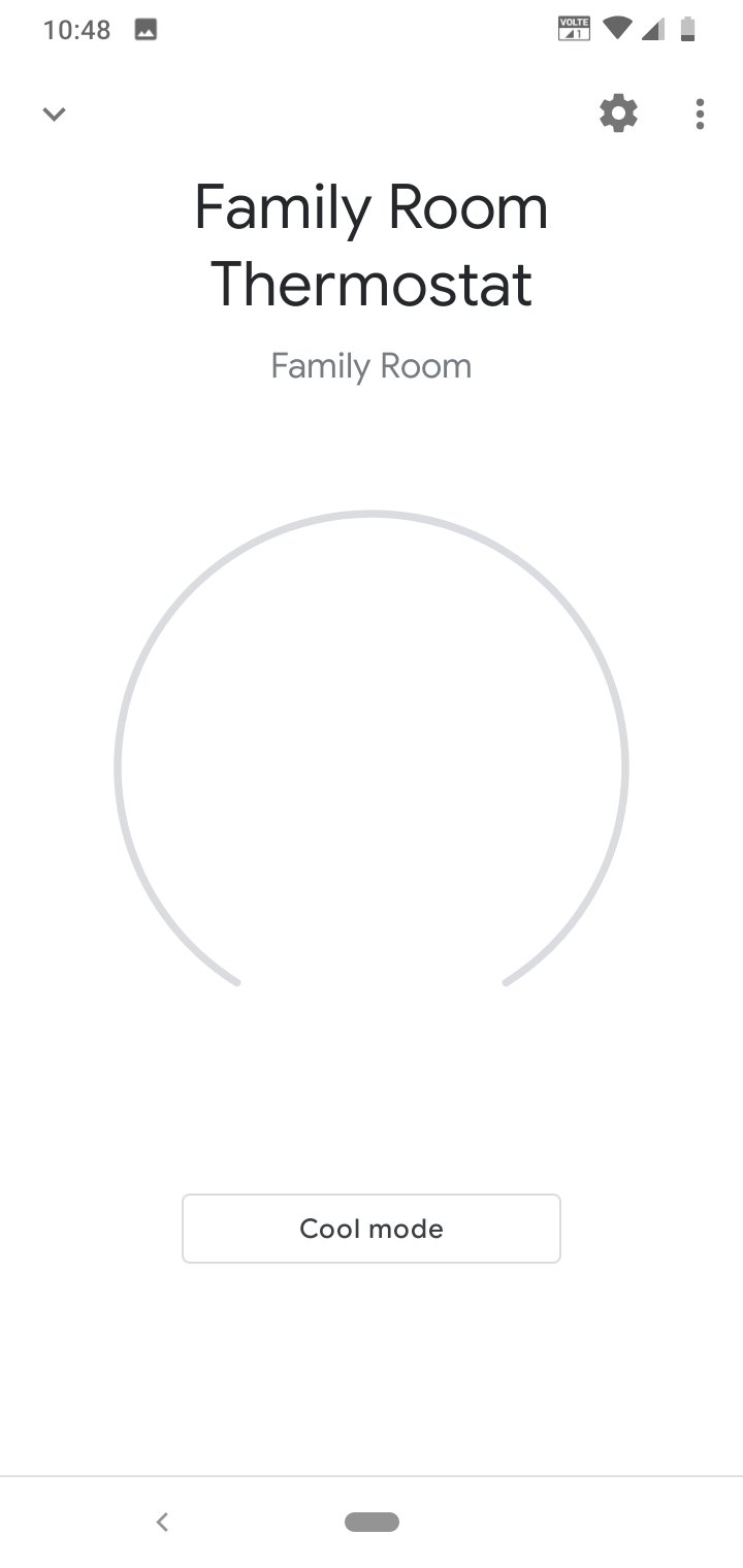

With Fahrenheit tag:
Without Fahrenheit tag:
Only the setpoint seems to report in Celcius, (32). The actual temperature value is still in fahrenheit, probably because this is the direct value read from the temperature sensor, and therefore no need to “transform” to either celcius or fahrenheit.
I can confirm, using , “Fahrenheit” in the [ “Thermostat” ] do indeed break the thermostat so no info gets through (other than an empty thermostat).
I just tried adding “Fahrenheit” to one of my thermostats, and it turned out empty as well.
