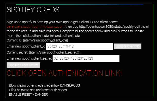

What do you mean reauth? The way it should work is you auth once, then the script will handle all the authorisation and getting new keys in the background.
Make sure you go through the instructions thoroughly and it should work.
If you are still struggling you can try a widget to made, it should cover the main instruction on setting up authorisation.
Remember to change the clientid, secret, openhab name/ip:port then you should be good to go.
<div class="section" ng-init="new_client_id='clientid';new_client_secret='secret'">
  <widget>
    <div class="title">Spotify Creds</div>
    <div class="name"> Sign up to spotify to develop your own app to get a client ID and client secret <a href="https://developers.spotify.com/my-application/">developers.spotify.com/my-application/</a> then add http://openhabian:8080/static/spotify-auth.html to the redirect uri and save changes. Complete id and secret below and click buttons to update them. then click authenticate link and authenticate</div>
    <div class="name">Current ID: {{itemValue('spotify_client_id')}} </div> &#13; <div class="name">  Enter new spotify_client_id <input style="color: black;" ng-model="new_client_id"  size="35"  />
    <button ng-click="sendCmd('spotify_client_id', new_client_id)">Update Client ID</button></div>
    <div class="name">Current secret: {{itemValue('spotify_client_secret')}}</div> &#13; <div class="name"> Enter new spotify_client_secret <input style="color: black;" ng-model="new_client_secret" size="35" />
    <button ng-click="sendCmd('spotify_client_secret', new_client_secret)">Update Client Secret</button></div>
    <div class="title">&#10;<a href="http://openhabian:8080/static/spotify-auth.html" target="_blank">Click open authenication link!</a></div>
    <div class="controlGroup">
      <div class="heading">&#10;Blow clears other creds credential- DANGEROUS</div>
      <div class="name" ng-init="display=0">Click below to see and reset auth codes</div>
      <div class="name" ng-click="display=1">ENABLE RESET - DANGER</div>
      <div class="nameGroup" ng-if="display==1">
        <button ng-click="sendCmd('spotify_auth_code','NULL')">Reset</button><div> {{itemValue('spotify_auth_code')}}</div>
        <button ng-click="sendCmd('spotify_access_token','NULL')">Reset</button><div> {{itemValue('spotify_access_token')}}</div>
        <button ng-click="sendCmd('spotify_refresh_token','NULL')">Reset</button><div> {{itemValue('spotify_refresh_token')}}</div>
        <button ng-click="sendCmd('spotify_token_expiry','NULL')">Reset</button><div> {{itemValue('spotify_token_expiry')}}</div>
      </div>
    </div>
  </widget>
</div>
