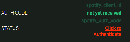

There is nothing wrong with the widget, as mentioned this was working fine before.
I use the widget to enter the client id and secret, it authenticates correctly. But when I go back into the Open Auth link, it seems its not authenticated.
I also cannot see the token and so on being stored in Influx DB
Its not saving the token it seems.
This was working perfectly before.
The static/spotify-auth.html page will not be clear that it has been authorised. But once you done it once you should never need to do it again. Here mine is fully authorised and work and this is what the auth link looks like.

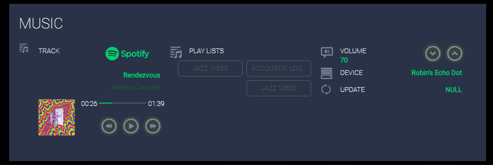

@tr1cks I’ma lso having this problem where the device list goes away on refresh. Then if I edit layout and click run, it comes back.
Any idea what’s causing this?
Hi Guys,
I am able to execute with full success the script (/usr/bin/python /etc/openhab2/scripts/spotify.py) and it updates everything in HabPanel however it doesnt keep all the playlists and devices there, they seem to disappear after a while.
This was working quite well before but seems to have broken when I reinstalled OH2.3.
My persistance is fine, as the file is the same as what I was using before also.
Any thoughts?
@unparagoned you’re quite experienced on this :slight_smile:
Any thoughts
Script appears to work all fine from the console but HabPanel wont hold the display of the devices, playlists etc.
No sound comes out either . I used to see logs in the console constantly of things being refreshed and updated but now only when I execute the script manually do i see that " /usr/bin/python /etc/openhab2/scripts/spotify.py"
Thoughts?
The sound comes out of the Spotify program, so that needs to be running. Start playing music with Spotify and then start controlling it with openhab.
I added refresh buttons for Spotify, playlists and devices. So when you press the refresh button it assigns the item to the display item again. There should be code in my previous posts
