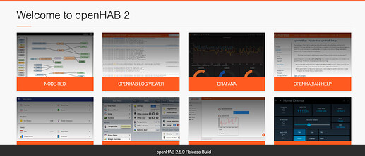

Hi All. i have resently upgraded my ubunth to the new lts. and now my log viewer seems not to work no more.
it shows on my gui . but once you click on it to go to port 9001. it just gives me This site can’t be reached.

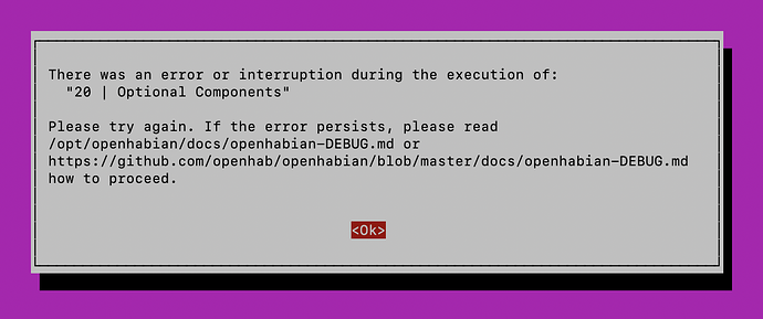

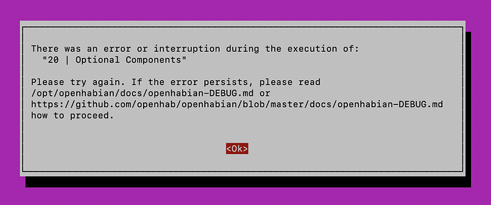

i have tried everything. from re installing it. it even fails on the install via openhabian config
cant find much on this

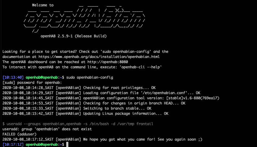

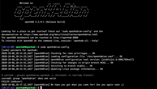

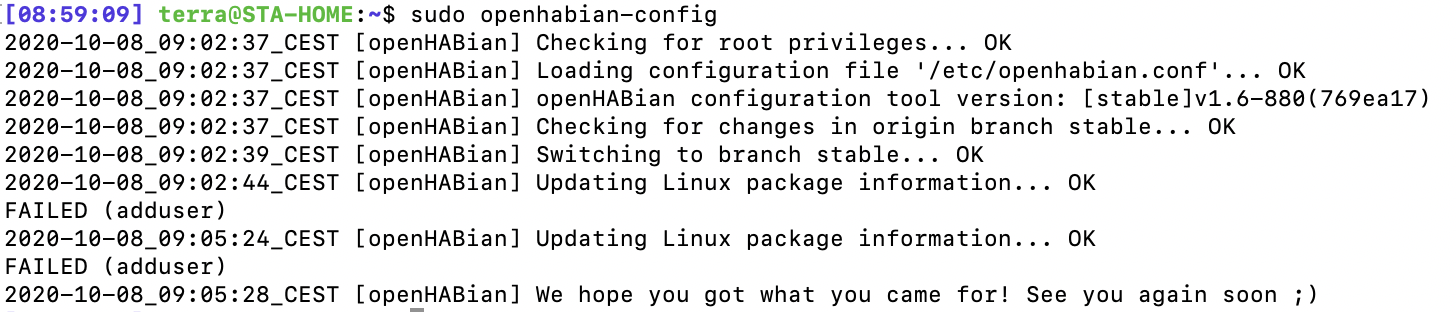

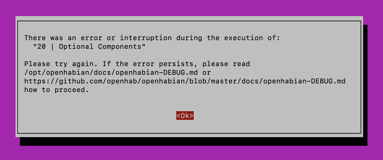

The openhabian group seems to be missing. This is why the user is not being added.
Check if it is missing. If it is missing add it and try to add the user again.
IT IS BORN AGAIN.
sudo addgroup openhabian
[sudo] password for openhab:
Adding group `openhabian' (GID 1001) ...
Done.

$ useradd --groups openhabian,openhab -s /bin/bash -d /var/tmp frontail
