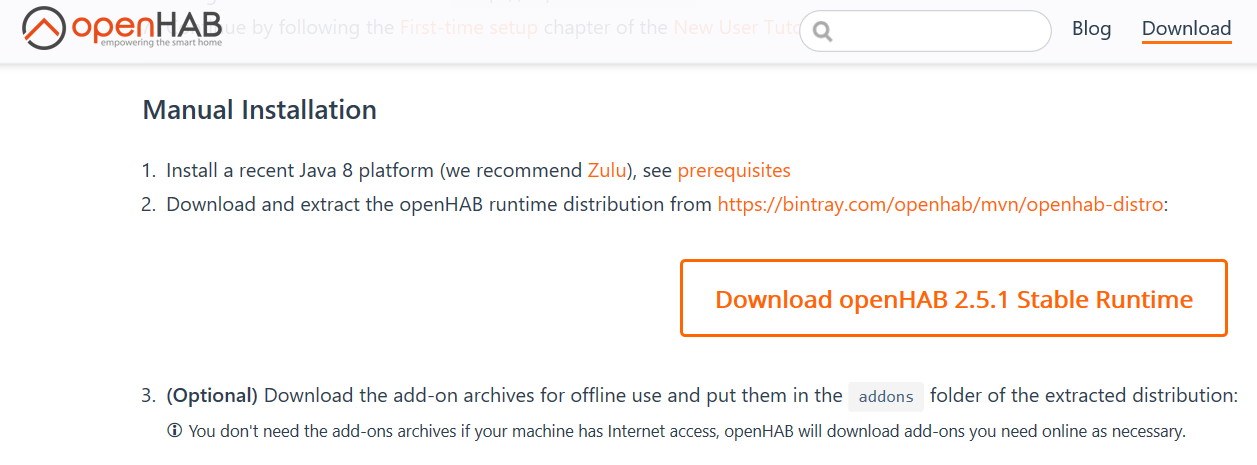

I just looked there is no Zulu link here.
Pi 2 and greater are needed for openHAB anyway.
I used NOOBS lite and it probably contain Raspbian Lite… maybe i should use full Raspbian
That is not an openHABian page.It is an openHAB Download page. It expected the majority of user there to be running x86_64 CPUs.
