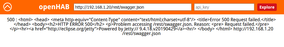

If i activate the chromecast binding in m2 then the rest api ui stops working.
Getting errorcode 500
Verified. & deleting the binding restores REST APi functionality. Here is the start of the log.
2019-08-26 14:29:57.627 [WARN ] [org.eclipse.jetty.server.HttpChannel] - /rest/swagger.json
javax.servlet.ServletException: javax.servlet.ServletException: org.glassfish.jersey.server.ContainerException: java.lang.VerifyError: Bad type on operand stack
Please report the issue on Github.
Is done
https://github.com/openhab/openhab2-addons/issues/5986
