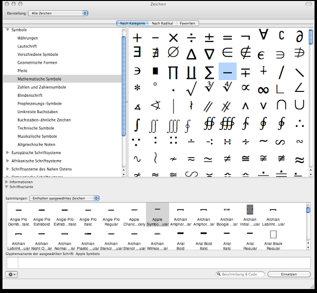

just a minor tweak, but you should consider avoiding those special characters, as they tend to confuse humans - and algorithms. I personally think underscores are fine, but there are loads of different “-” out there, which could accidentially slip in and until you figure out, what’s going on, you spend a night with error logs! :persevere:
http://4.bp.blogspot.com/-fUlpaZwsnrU/ToL-a80Us3I/AAAAAAAAA9c/misOcGHU0WQ/s640/Bildschirmfoto+2011-09-28+um+12.50.07.png
