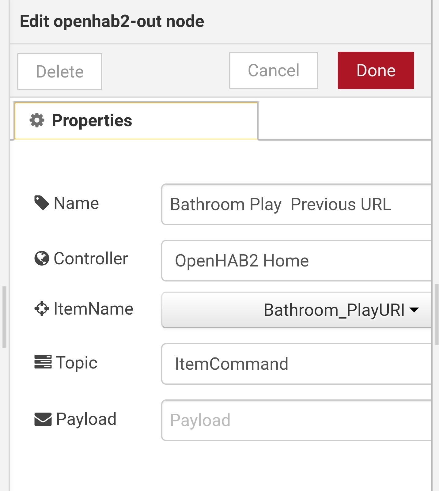

Hi
Do you mean that you are actually typing in that text?
Or leaving the field blank, so that it defaults to using the msg.payload?
For example
This will send out whatever the msg.payload contains (IE the payload of the trigger.)

Meaning that however you trigger that node, the output will be whatever is typed into the last field box.
Valid entries in that field might be
  • ON
  • OFF
  • 0
  • 85
  • 160,100,100
  • SET_LED
Or whatever the openHAB2 Item accepts.

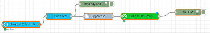

OK. I figured it out. I feel stupid, kinda sorta not really.
Looked at my data and experiments. Payload of “ON” worked. Payload of “on” didn’t work. It appears the openhab2 REST API doesn’t like ON or OFF in lower case. I added an uppercase function in the flow and all is happy!!!
