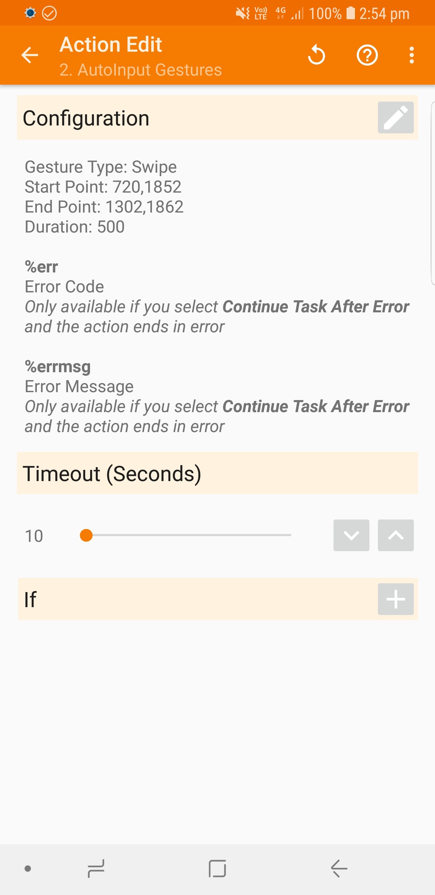

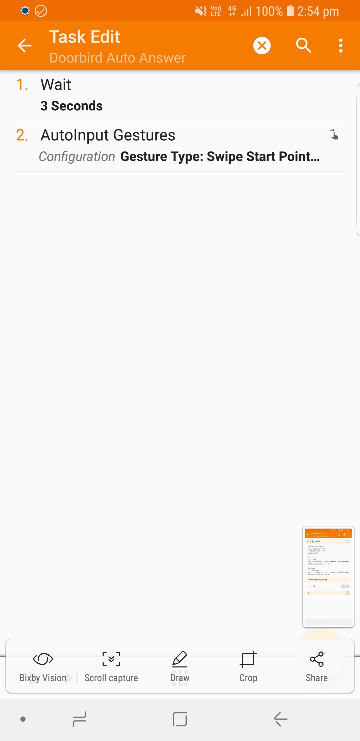

Im trrying to use Auto Input but am getting no joy. I worked out the coordinates for the swipe and set my Task to AutoInput, swipe with the start/end but it doesnt appear to do it.
When a call is received, the phone pops up Zoipher with a Phone ringing in the centre, theres a few seconds between the pop up so I put a 3 second wait in there, but alas, it wont swipe the accept for some reason :confused:

I don’t know how well auto input works with draw over notifications. what happens if you open the app while it is ringing? wait the three seconds, open the app, and then see if AutoInput will work in the actual app.
in my experience, auto input requires repeated experiments until you find something that works. sometimes you never do. and the slightest change in the app will break the auto input task. it’s crazy powerful but very brittle.
Autoinput for a gesture wont capture the screen im afraid.
It only lets you input cooordinates
Too finky for my liking it seems. Ill see what the reddit guys say about getting it going.
