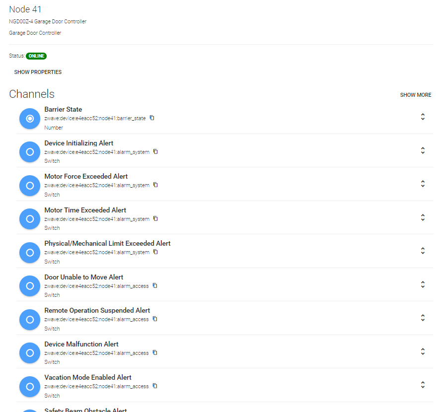

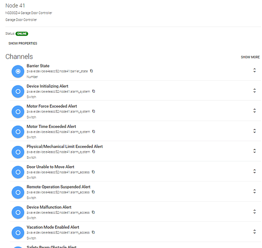

But this is what I see:
One other thing I notice is that barrier_state for me shows 253 regardless if I send 0 or 255.
I don’t see barrier_position at all below the screenshot so I’m wondering what’s wrong with my configuration. Thanks again for the help.
