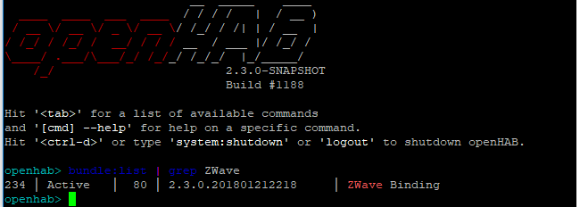

How do you connect the lock to openhab?
You need to use the development version of the binding - see this thread for more information (the first 10 messages or so should give you the installation information).
Thanks! I already installed manually the binding but I can not discover the lock when I scan for a thing in Paper UI. Nothing shows up.
What do the debug logs show?

I do not know what is the NODE 2: Device discovery event… because before I tested with all my zwave devices off and still have that event on the log.
Please also describe what you are doing. To include a lock, you must include it directly through HABmin (or PaperUI) - reset the lock, put the binding into include mode, then see what happens. I really suggest to use HABmin as it will provide more feedback.
We also need a debug log - this really doesn’t provide a lot of information. Put the binding into debug mode with log:set DEBUG opr.openhab.binding.zwave.

Hey folks not sure if I should open a new post or not. I was able to get the latest Beta z-wave binding and included my lock with security. I thought all was well but noticed that although I can control my lock, I can’t get updates from the lock when it is manually switched. I have 4 of these and all are doing the same thing so I am pretty sure the locks are not the problem. I also had them working properly in Vera before moving over to openhab. There is nothing in the karaf logs even if I put them in debug when I manually open or close the locks. When I control it from OH, I do see the proper messages indicating ON to OFF and vice versa. I also see the Alarm raw log update. Is there anything I need to set for the lock to communicate back when manually locker or unlocked? When I lock or unlock from sitemap the response is within seconds so I don’t believe there to be a communication issue. My mesh looks pretty well established as seen below.
The one lock I am doing my constant testing with just because it is closer is node 37. There are another two z-wave light switches within 5 feet of it along with my thermostat so I doubt that it has anything to do with being able to reach the controller. I’m thinking its something I haven’t set up. Is there anything I can upload here that can help with the troubleshooting?
