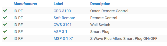

Sorry, it is CWS-3101. So is supposed to be supported, right?

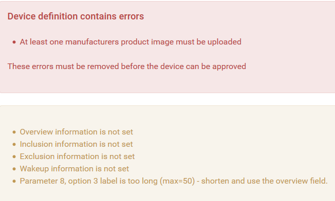

Yes, but some basic information are missing:
https://www.cd-jackson.com/index.php/zwave/zwave-device-database/zwave-device-list/devicesummary/294
But it looks like it has been included into the binding. You may need to use a recent zwave snapshot or development version of the zwave binding, though.

And please find the time to update the database with the missing information:
thanks for the answer.
I asked Chris Jackson yesterday and told me that the missing information should not be a problem.
Sorry, but I am not sure how to use a recent Z-Wave snapshot or deveopment version of the z-wave binding. I just installed the binding from the OH2 web interface. Please, could you explain where to get this from?
About updating database, not sure I can do right now. Perhaps need to ak for rights to do so?
