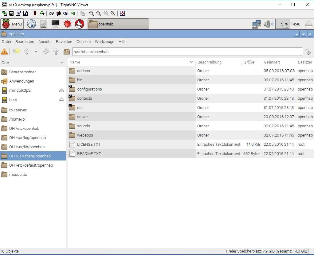

If that is a MUST, then you could go with
tightvncserver and a vnc client on your desktop.
https://www.raspberrypi.org/documentation/remote-access/vnc/
