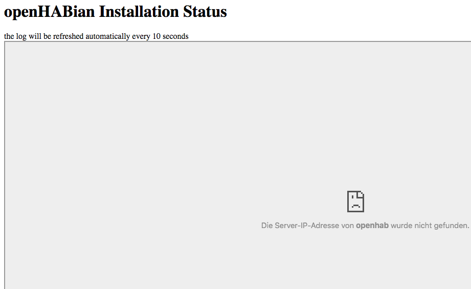

I tried to install openhabian today for the first time on a new SD for a friend. I wanted to watch the installation progress with the technique mentioned in the documentation. Unfortunately it is not working:
What’s your hostname ? Try using that for the embedded link (http://<hostname>/first-boot.txt).
This did not work when I installed opehabian 1.5 either. Not on PI 3B+ or PI4. But OpenHab work after installation is complete :slight_smile:
That worked!
