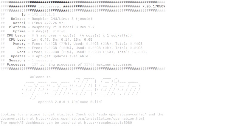

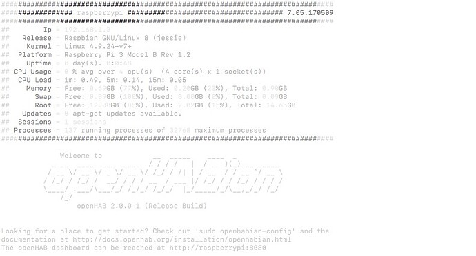

Wen your in ssh let openhabian start then enter $sudo su then netstat -nlp | grep 8080 what does it says it should be someting like this
tcp6 0 0 :::8080 :::* LISTEN 908/java
tnx, it returns nothing
look at the images below:

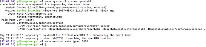

Otherwise, it’d be good to post the results of the following:
sudo service openhab2 status
sudo journalctl -f -u openhab2.service
sudo tail /var/log/openhab2/openhab2.log
If it’s a general Linux problem, I may be able to help.
did not change antthing
tnx, here are the screenshots of three commands:
