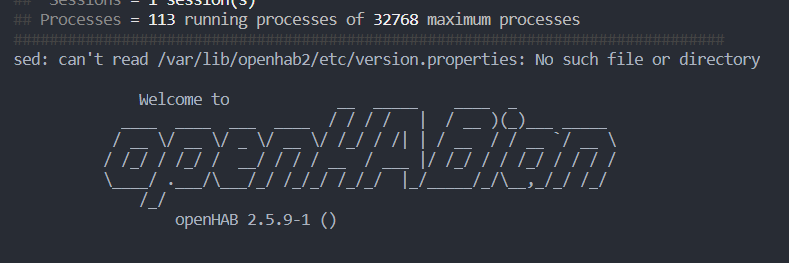

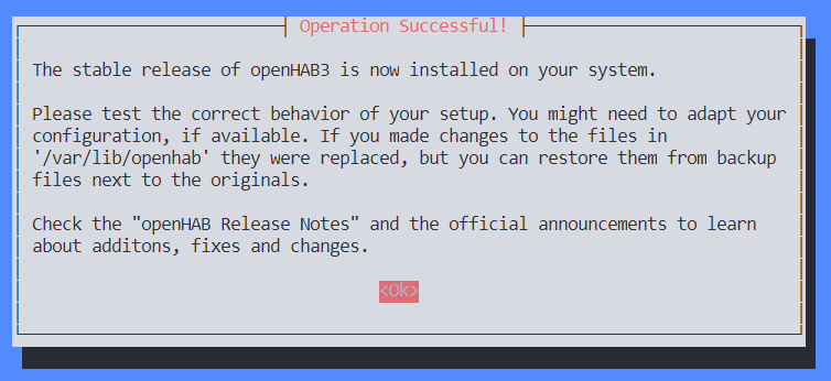

Hi Guys,
using a Raspb. 3B with openhabian 2.5.9.1. installed on SSD
created a backup and updated to OH 3 (installation complete)
but i can’t reach dashboard or anything else. i am only able to ssh via openhabian@openhab
also openhabian says
how can i get OH to start again ? its seems that it doesn’t run.
thank you!

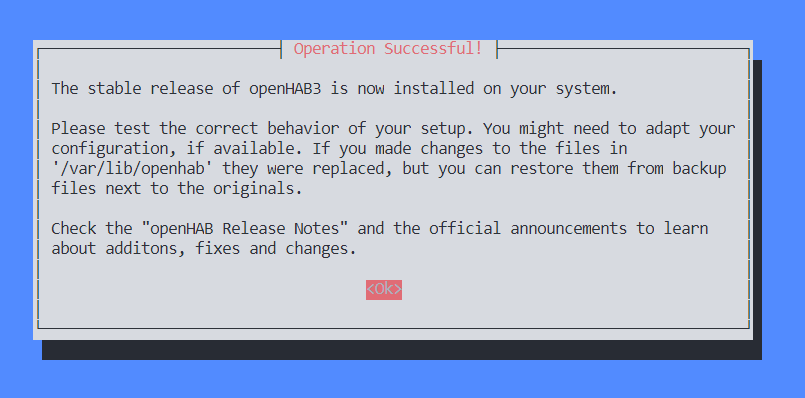

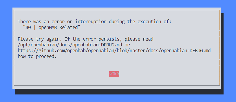

5
i am on openhabian 1.6.1 (stable)
Menu 42
did it a few times already
now i get this

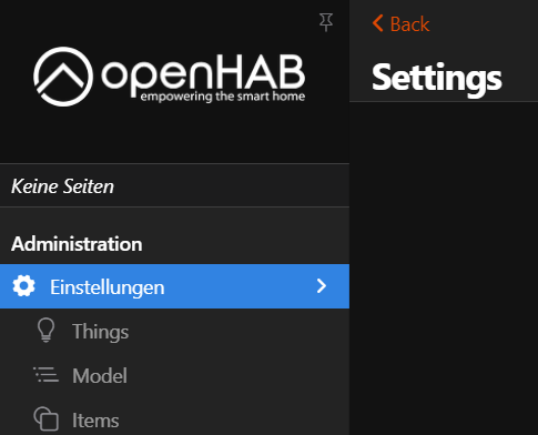

still no luck to see the Dashboard
RiotMode
(Philipp)
December 22, 2020, 12:34am
17
Finally made it , a few restarts & clear cache did the trick…
and started with
sudo /bin/systemctl start openhab.service
wohooo - @mstormi and @hmerk thanks for your help!
my steps to success in short:
check the log = cat /var/log/openhab/openhab.log
check if you can log in into console = sudo ssh openhab@localhost -p 8101
check the log there too = log:display
stop openhab = sudo systemctl stop openhab
clear cache and tmp = sudo openhab-cli clean-cache
start openhab with = sudo /bin/systemctl start openhab.service
only concern left so far, shouldn’t it be 3.0 ?
it works anyway but just asking.
