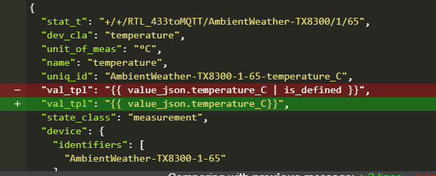

I waited for the build to finish and could upload the binary successfully. The version shows 775e81.
The configuration topic for my AmbientWeather sensor has now the val_tpl entry without “| is_defined” like expected:
So basically it looks fine, the value topics are correct and can be processed by openHAB.
I will look at the further processing and will also remove the Thing and wait for it to be recreated. I’ll keep you informed!

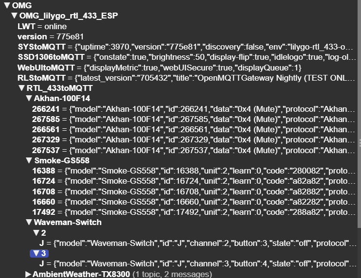

I face some issues with devices, that are not correctly recognized. I have a 433 Mhz based remote control, that is recognized by rtl_433 (native with a different SDR stick) as a Waveman-Switch device.
When I press some buttons with different channels selected, they are sometimes discovered by the OMG HA autodiscovery correctly and other times discovered als a Akhan-100F14 when I press a ON switch. Pressing the OFF switch, the device is discovered as a Smoke-GS558 device, but from time to time a config topic appears correctly for a Waveman-Switch.
See some samples below:
I have the test build from above. What is the right place to post such kind of issues regarding the rtl_433 integration?
Regards Christoph

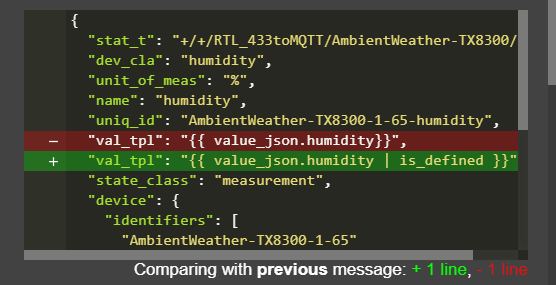

New version 15416e:
grafik
Keyword is_defined is back:
ohdiscovery was false and is then set by to true via system command:
In the new config message, the parameter is_defined is no longer present:
In the new config message, the parameter is_defined is gone again:
From my perspective the new command is working as expected.
