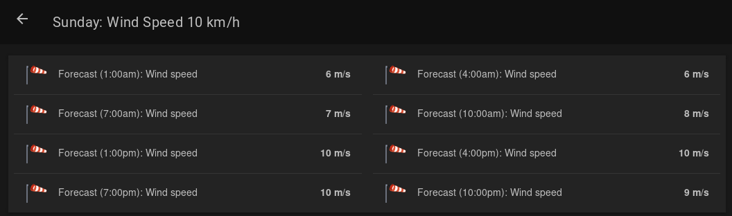

Let me please ask another question. For me the unit of Current_WindSpeed is m/s, but for the forecasts it is km/h. Is there any chance to make thoose equal?
Sorry, I missed your post. UoM is using km/h as the default unit for speed, and the script is just using the defaults.You could definitely modify your version of the script for this by using m/s instead of %unit%.
@5iver no problem. Good to know I can change the unit by myself, but unfortunately, I couldn’t explain the problem properly. What confused me is that I get two different units from one execution. Current is m/s and the forecasts are km/h. I would like to use the default km/h for all of them. I didn’t modify your script so far.
