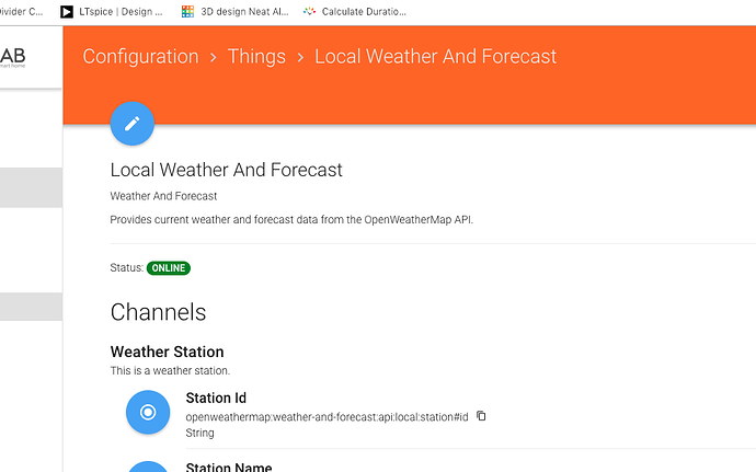

I have this in my weather.thing
Bridge openweathermap:weather-api:api "OpenWeatherMap Account" [apikey="##############", refreshInterval=60, language="en"] {
    Thing weather-and-forecast local "Local Weather And Forecast" [location="-25.78, 29.46", forecastHours=0, forecastDays=7]
    Thing uvindex local "Local UV Index" [location="-25.78, 29.46", forecastDays=7]

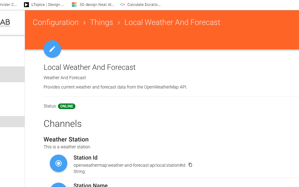

I bet if you check in Paper UI, that it is not online. I use managed Things, but used this in testing (note the forecastHours and forecastDays)…
Bridge openweathermap:weather-api:api "OpenWeatherMap Account" [apikey="5", refreshInterval=30, language="de"] {
Thing weather-and-forecast local "Local Weather And Forecast" [location="51.0000, 6.0000", forecastHours=120, forecastDays=0]
Once you get the Thing sorted, you will need to uncomment the removeOWMItems line, to start with a clean slate for the Items.

got it ..
I’m not sure what you’re saying :slight_smile:. The error is ugly… what change did you make to the Thing file? Maybe a bug with unmanaged Things? Remove the file and create it Paper UI?
Without the forecastDays set to 0, the free API key will not work. Without forecastHours set to 120, the script won’t work.
OK, cool!
now this. just need to get them on mi sitemap. and the scale :
I removed the thing on paperui and recreated it.
I also changed the the days to 0 and hours to 120
2019-02-04 19:55:53.780 [WARN ] [ui.internal.items.ItemUIRegistryImpl] - Exception while formatting value '117.5 °' of item localCurrentWindDirection with format 'SCALE(windDirection.scale):%s [%.0f %unit%': Format specifier '%.0f'```
This Item did not come from the script. But the name looks familiar… like SimpleMode was enabled and the name was pulled from the binding, but that wouldn’t have added the transform part and the incorrect formatting. Did you create this one?
