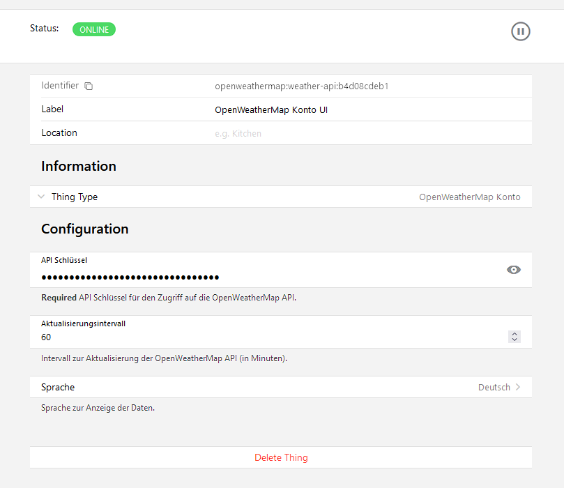

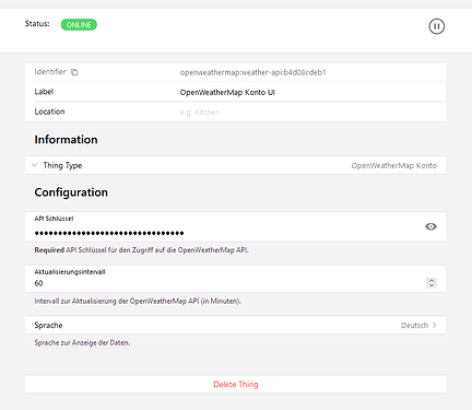

    It should look like this:
  3. Wait until the bridge is online. A bit of patience is needed.

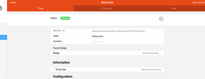

  4. Proceed with implementing the things you need. In my case a “weather-and-forecast” thing:
    Ensure the correct parent bridge is selected. Normally you only have one and that one should be preselected automatically.

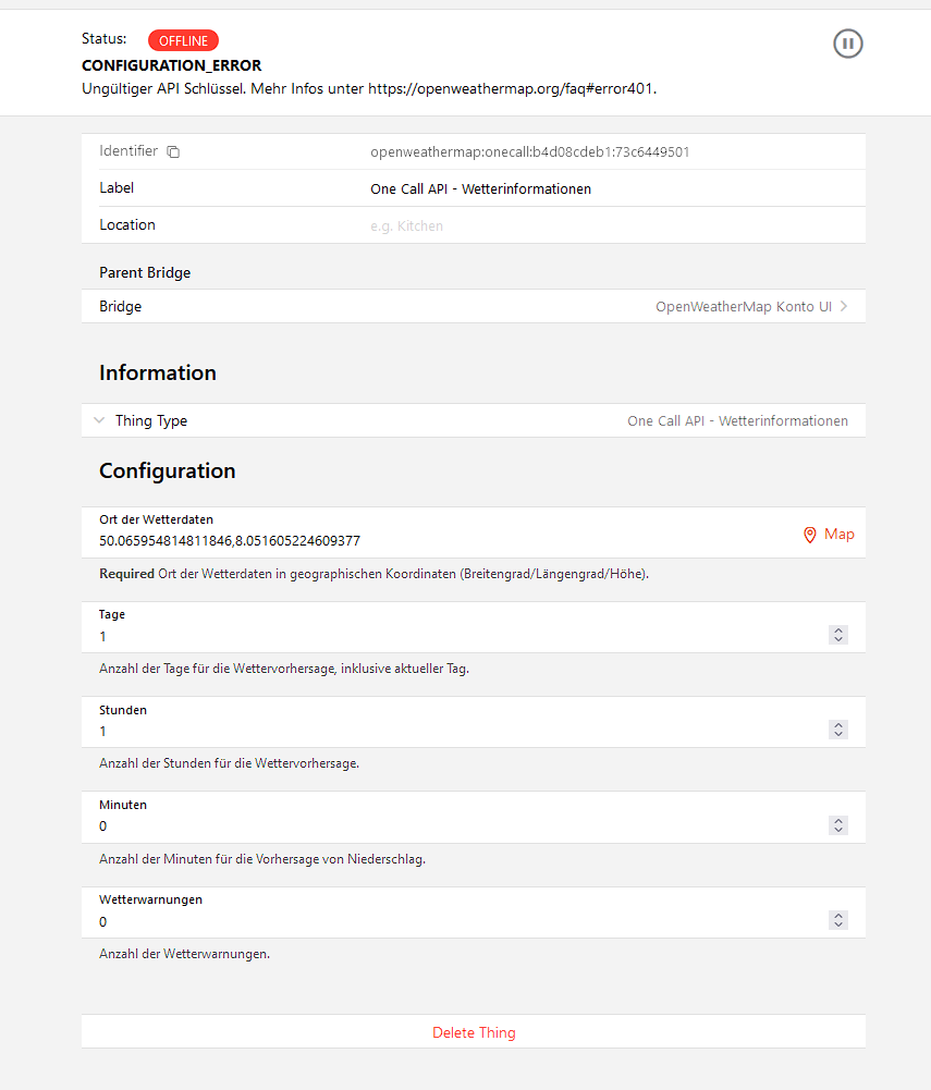

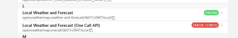

    The strange thing is, when I create the “weather-and-forecast” as thing, everything works normal, bridge and thing are ONLINE afterwards.
    When I add the “onecall” thing in addition, the new added thing is first UNKNOWN and then changes to OFFLINE (CONFIGURATION_ERROR).

Yeah, this was also something I played around with quite a long time.
Just did another test to be certain, it does not matter what I put in there.
Below a screenshot with Number of hours and Number of Days set to “1”.

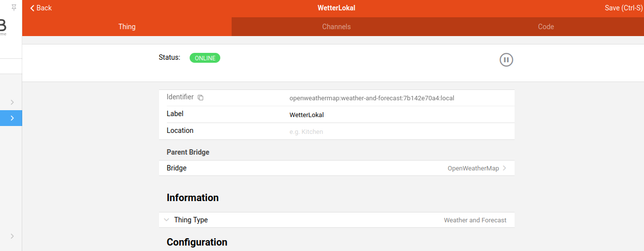

If I remember right I did not add any thing manually.

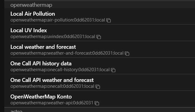

I think they came up automatically:
As you can see my things having “local” at the end, yours has just digits.
I don’t know if this makes any difference.

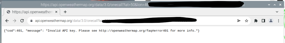

When I enter this link in a browser (with the actual AppId of course) I get the same message like shown in Openhab (“Invalid API key …” )
https://api.openweathermap.org/data/2.5/onecall?appid=*****&lon=6.959960&exclude=minutely%2Calerts&units=metric&lang=de&lat=50.974462
For reference, this is the template request from the OpenWeatherMap site:

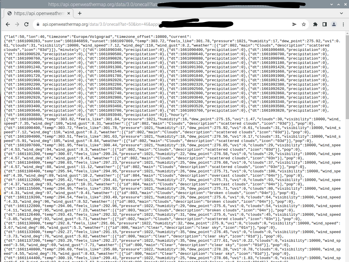

https://api.openweathermap.org/data/3.0/onecall?lat={lat}&lon={lon}&exclude={part}&appid=
After further testing in a web browser I found out that the number “2.5” in the bindings API Request seems not to be correct anymore (at least in my case with a brand new subscription). When I change it to 3.0 like shown in the OpenWeatherMap template, I receive the complete list of Items in my browser.

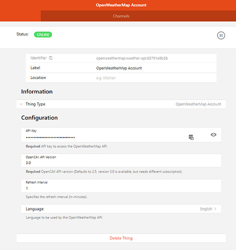

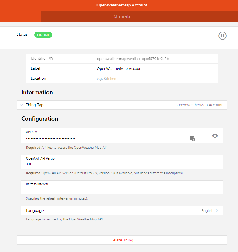

Hi, I’ve put together a draft PR to allow the One Call version to be set in the open weather account thing settings.
@rossbuggins Can you download your binding version already? Im not quite familiar with github / dont find the download there :smiley:
It’s just been merged into main, so I think the latest version snapshot should have it - but just get someone else to confirm :+1:

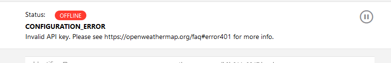

Problem is that after 20hours I still have error :
But only one call api. second one is online.
error information is :
but I used a API which I received via e-mail.
