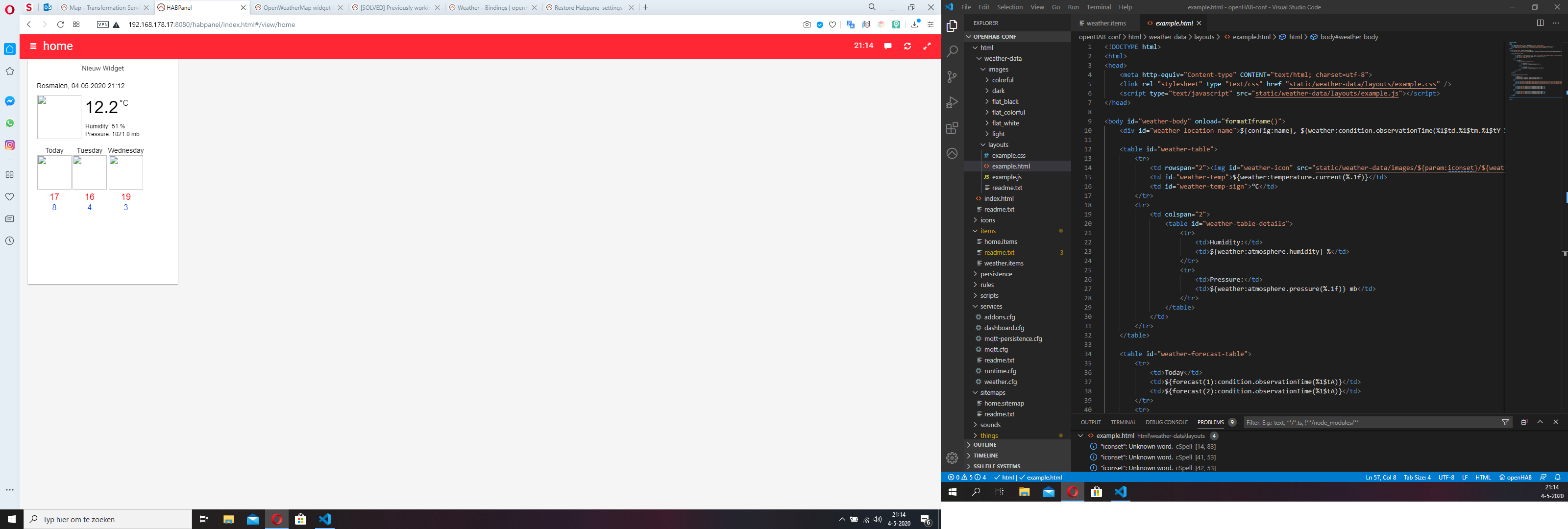

Thanks I’ll take a look. For now I noticed that there are days that are displayed correctly and eg today and the next 3 days are ok (non of them repeat) and next day when I look in habpannel I see that two of them are the same day like the picture above! Next day again everything ok! What’s the issue here?

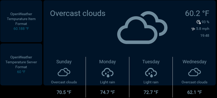

I need some help formatting number items in the OpenWeatherMap widget. I’d prefer that number items be displayed as whole numbers, without any decimal places. I’ve tried changing the formatting on the Item, changing "[%.1f [%;unit]" to "[%.0f [%;unit]" but that does not seem to have any effect in the widget. A Dummy widget specified with “Use server defined format if available” displays the value as an integer, a Dummy widget with no format specified displays the number with 3 decimal places, and the OpenWeatherMap displays it with one digit. My item definition is:
Number:Temperature		Weather_OWM_Temperature			"Temperature [%.0f %unit%]" <temperature>		{channel="openweathermap:weather-and-forecast:80924c3e:local:current#temperature"}

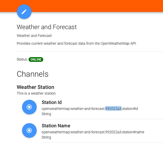

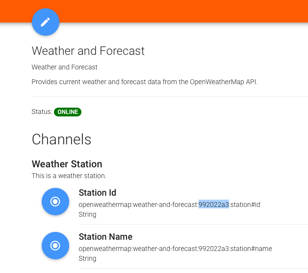

where do i get the ’ Local weather and forecast’ thing id?
i can’t find a hexadecimal value…
In the Paper UI, go in the item Weather and Forecast
Also, FYI, I had to remove the :local: from the item file, then everything is working now

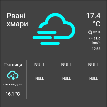

Very nice looking widget, though mine’s not fully functional yet. Installed as per instructions, rechecked file structure and everything is in its proper place. However, in Habpanel the only items displaying correctly is the sky condition, temperature and wind speed. Everything else is NULL, and no icons appear anywhere. I get the items to display in separate dummy widgets, and I also see them in PaperUI>Control and in BasicUI. Any ideas where to look and fix?
When your widget shows just an empty screen, the solution can be to just open the Widget’s settings and Save it (even when you don’t want to change anything). Only then the ‘colorsettings’ are used.
