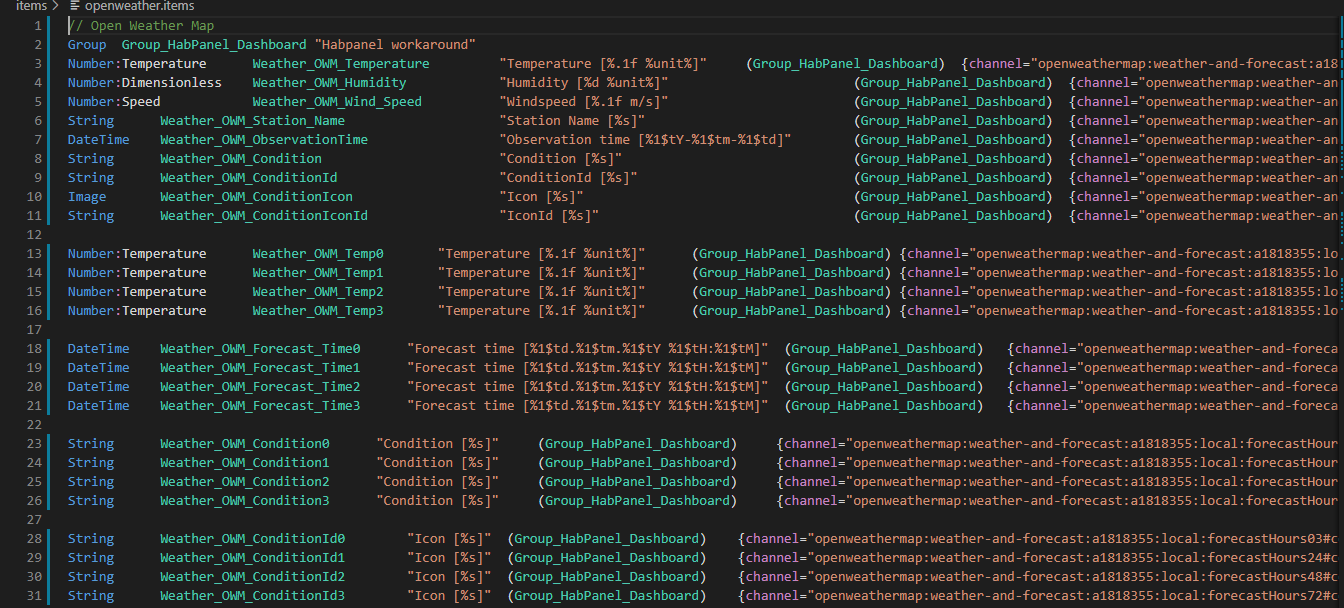

Items file
Habpanel
I used OpenWeather before switching to DarkSky, as I recall it can take quite a bit of time to refresh the forecasts, so that could be a possible cause. Are you giving it a chance to refresh the forecast (hours of time as I recall). Since you are using text files, be sure that you have no typos or hidden characters. I found that if I used keyboard commands to copy and paste I sometimes had “control characters” embedded in the paste. Try redoing a few of your Items to see if that helps. Otherwise I am at a loss as to why it should not work.
Just as an fyi. It is better to use code fences rather than screen shots when posting on the forum. It makes it easier for readers to evaluate your code. I really am unable to see your complete channel definitions.
all works fine without filtering, double-checked for any errors - all fine
resolved, added to all items required group.

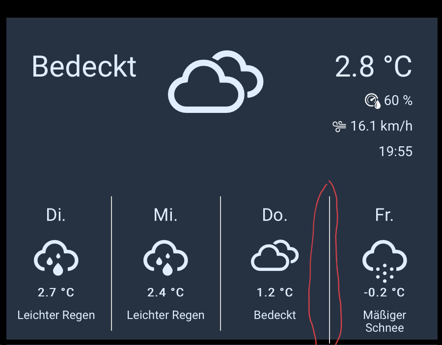

Hi Bastiaan,
Great widget you made! So far so good, just struggling a little bit with formatting issues. I have screened this thread for formatting issues, and md-Col solution but I am not sure if this is the same error?
I wonder why the widget has a different height than the right one for example? In any case I have the same kind of format issues in chrome with 1080p resolution as well as 2k resolutions.
@bastiaan_van_h Any idea what I can do to adjust this better?
Thanks and happy holidays

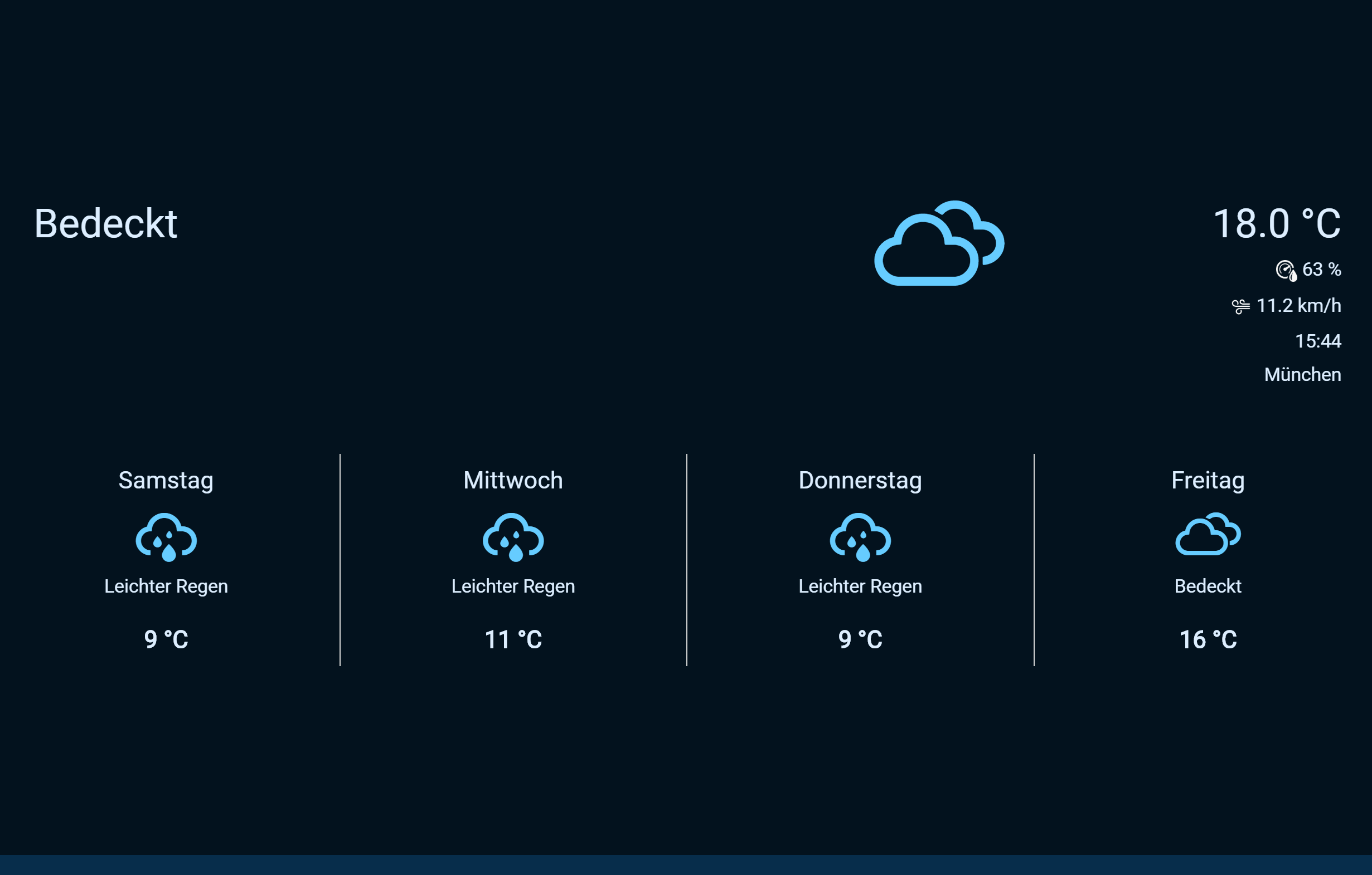

This is how it looks like when testing the Imported Json with no further adjustments on a 1080p screen. What is the problem for this format then? :thinking:
