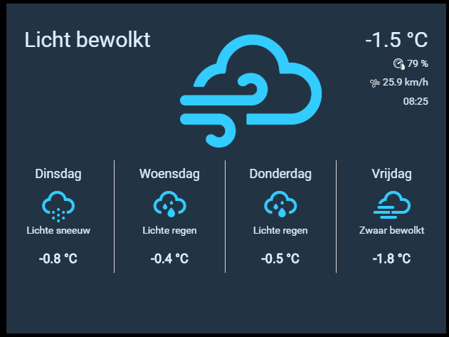

Screenshot (Dutch language):

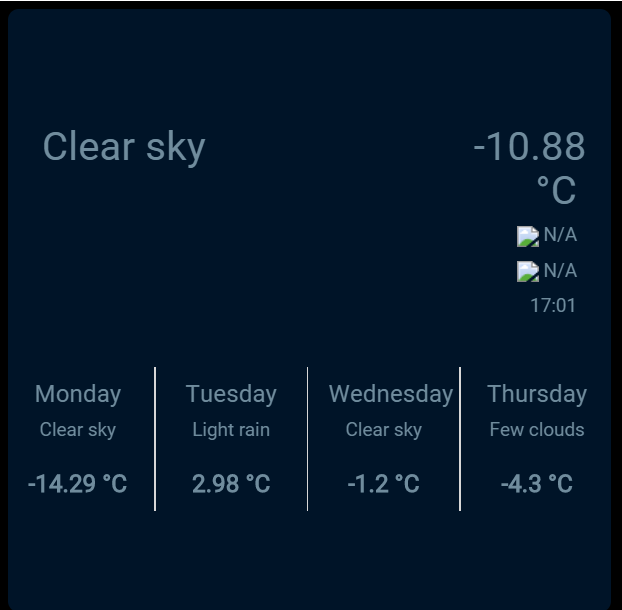

OK - I sort of have it working, but there are a couple of problems…
Its displaying in Celcius, and I want Fahrenheit. I can’t figure out how to change this. The documentation says to use a “unit=fahrenheit” parameter, but I can’t figure out where to put this - this clearly doesn’t work:
Number:Temperature      Weather_OWM_Temperature                 "Temperature [%.0f %unit%]" <temperature>               {channel="openweathermap:weather-and-forecast:b6c4707a:local:current#temperature unit=fahrenheit"}
There is also a global unit declaration I guess, but I can’t figure out where to put that either.
Also, the temperatures are displaying with 2 decimal places, and I can’t seem to fix this (I want no decimals).
I also found that when I try to display this widget on an iPad t the forecast doesn’t work right - it stacks them vertically rather than horizontally. It displays properly on my Windows 10 PC, but not on the iPad. Any ideas?
Help!
Bruce
EDIT: Icons are working now (it was a permission issue)
it looks like humidity and wind speed refer to the “old” items, without the OWM in the item name… :wink:
Yes, well spotted.
I have corrected the item names of windspeed and humidity. And I’ve set the temperature decimals forced to 1. Please download the updated widget from the github page.

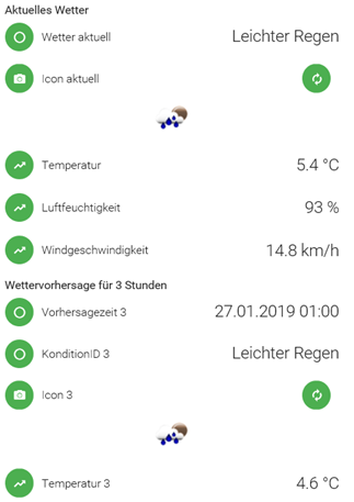

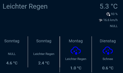

great job, great widget. I have 1 question and 1 problem:
Question: is it possible, that the forecast will show the weather/temperature always at 12 o’clock? If I look to weather forecast e.g. at 8 pm, the 48 hour forecast will show the temperature in 2 days at 8 pm, which could be confusing.
Problem:
the icons are only shown for 48 and 72 hour forecast, but not the current weather and forecast of 3 and 24 hours.
When I view the items in PaperUI, all icons are show correct
PaperUI:

In reply to your question: When I have the time, I will try to make the 12:00 o-clock logic into the widget.
For the missing icons, the widget is not using the ‘icon’ channels as it has ugly icons. Instead it uses the ‘condition-id’, which is an integer and gets the corresponding icon from the ‘weather icons’.
Check the Weather_OWM_ConditionId0 and Weather_OWM_ConditionId1 channels values by adding the Dummy widget.
I see you have more NULL’s, so could be your items aren’t setup right.
