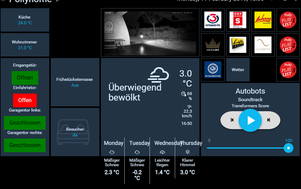

I also dont find a channel in the weather and forecast thing for the Weather_OWM_ConditionIconId item. Right now the widget looks like this:
In PaperUI all the different items receive their values (except the Weather_OWM_ConditionIconId item).

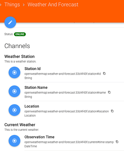

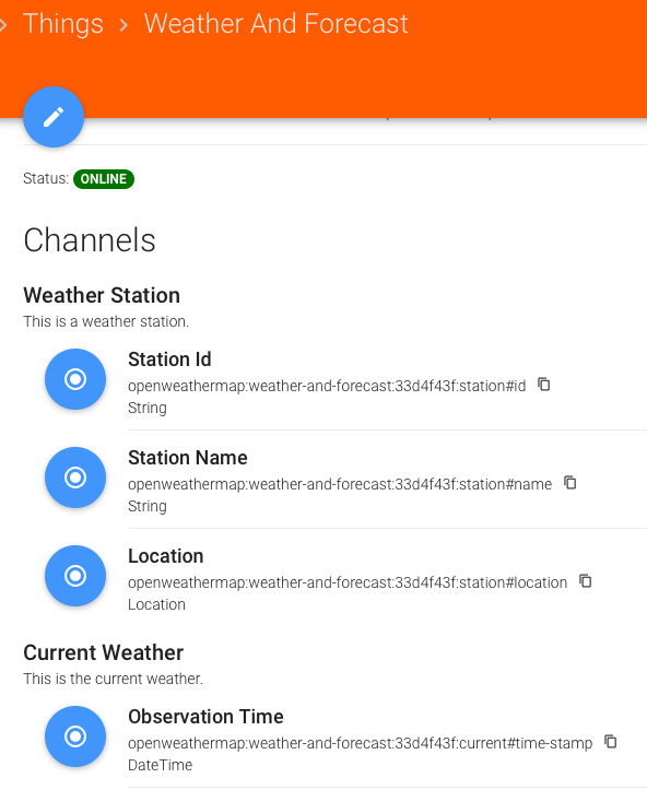

can anyone tell me how can i find my ID ?
My channel link looks like this (openweathermap2.4 binding):
openweathermap:weather-and-forecast:api:local:station#id

You can see the ID in the log file, e.g. when you add the weather informtion thing. Important: do not take the ID from the accout thing.

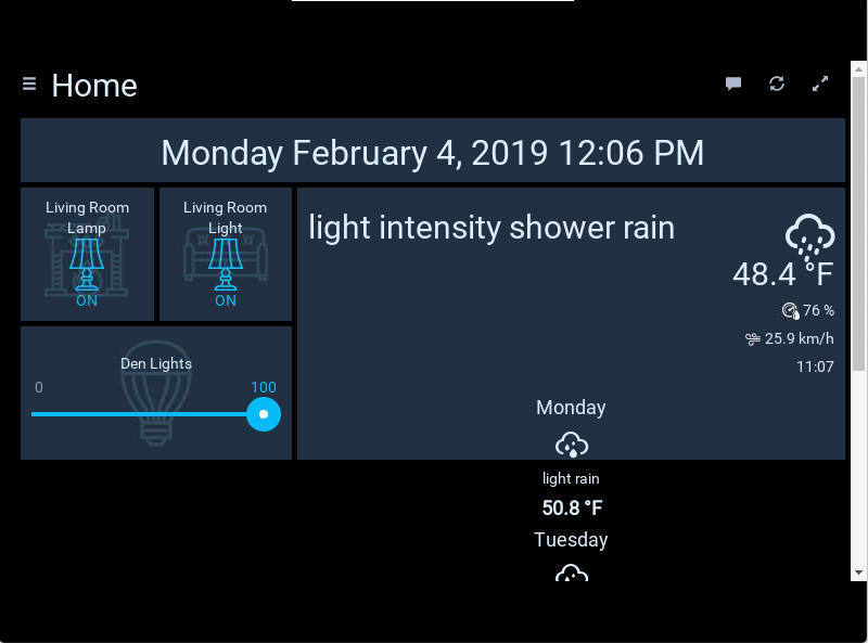

I have a RPi with 7" touch screen. I’ve installed Firefox and Chromium and in both browsers it looks like this:
The forecast is stacked on top of each other and the current weather icon is in the wrong place.
I’m able to resize the icons but is there an easy way to resize the text?
Also, the configuration for Imperial (US) works well (THANK YOU!!) Except the current weather show km/h rather than mph. Couldn’t find the text in the set up.

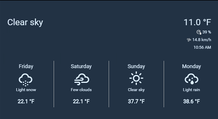

Hi Bastiaan,
I have got a problem with your widget.
It worked perfectly, and suddenly stopped. I completly deinstalled everything and started new, but the same problem occured. I have used the right ID, I have got the right Fiels and Folders, but I am not sure what it could be.
The three widgets on the right are dummies to show that I am useing the right ID and so on.
I solved the issue by my self. The problem that I had was located in the items file.
Number:Temperature		Weather_OWM_Temperature			"Temperature [%.1f %unit%]" <temperature>		{channel="openweathermap:weather-and-forecast:<your-id-here>:local:current#temperature"}
The :local: in the channel had to be deleted. Now the widget ist working like a charm.
