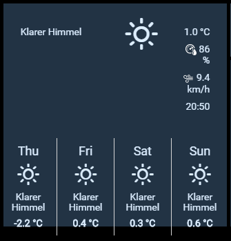

Have you checked the settings of the Widget? They contain options to adjust the text size. Otherwise you can alter it’s source code to set your own preferred css font sizes ext.
Whats you tabled screen size in pixels? I will see if I can find why it looks like that on this resolution.
1280 × 800 pixel …

Same result on tablet and pc browser too.
But it works fine with “col-sm-”
That doesnt make sense.
This value determines when a column should be placed below each other. Each value, sm, md-, lg represents a certain width. When using “col-” it will not stack columns.
Same thing with me. col- didn’t work but col-sm did!

my screensize is 1024*768.
I tried col-sm and col-xs but both don’t seem to change anything..
changing the fontsize via h4 etc. lowers the fontsize but then it looks like that:
how can one move the condition icon below the condition text?
I’d like to do that also, but my more pressing problem is the current conditions on the right side. They don’t quite fit in the space allowed.
The ºF is on the second line. I tried shrinking the font size and it didn’t look good and it didn’t work. How can I adjust the width of that column? Just moving it a few pixels should do it, I think.
