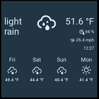

Mine looks like this:
The layout did not fit my screen either, so I arranged the code within habpanel editor.
You don’t see it, but the icons are even animated
see here:
Quite a while ago i saw the awesome Climacons from Adam Whitcroft and Noah Blon did very well with animation of these…
Then i saw that @ysc did a Iconset for openHAB aswell with some of the Icons in there (here )
Even if these icons are just a small feature in my own HABPanel.. i wanted to have all of them, so i can easily put them in any location where i need them… so I forked the repo, included all animated climacons, fixed the chrome display bug, renamed them to have the _sun and _moon …
My habpanel code for the upper part of th weather widget:
Please note: I habe changed the image syntax to match the animated icons - the original syntax is included in the commented lines (

With @NCO ’s encouragement (and a good website link) I have actually been able to figure it out. Here’s where I stand now:
I did it by splitting the current weather conditions into three <div>s with the icon and weather condition in their own rather than sharing one. I then fidgeted with the size of each one till I got it right.
Then I commented out the condition text for the forecast to save space and I bumped the font size down for the temp.
It all fits on my RPi 7" Touch Screen now!
In case anyone else is trying, here’s my code for the widget:

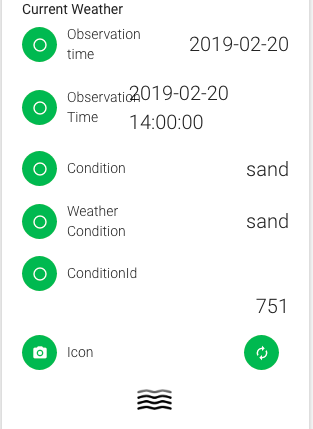

This isn’t a problem with the widget but I thought it was funny. Look at my current weather condition!
I live in the Mojave desert where we do have sand but that isn’t a weather condition!
OpenWeatherMap provided this condition as you can see from my Paper UI:
