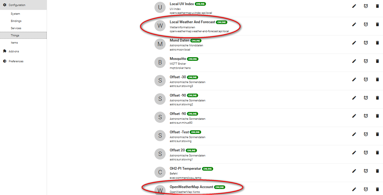

I see you changed the the .things-file. What does PaperUI shows for the Thing ?
and the Thing itself from current
to the highest
There we go!
In PaperUI the interval for weather data was set to the default value and not updated from what I defined .things file.
The reason is rather simple… My things file said forecastHour and not frecastHours.
My bad. Thank you for your help!
