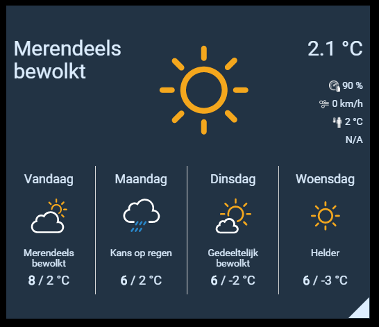

Hello all,
I would like to make my contribution to the Openhab community. I have created an Weather widget which uses the OH2 Weather Underground binding. Please note that you need the Weather Underground binding as of build version #1212, otherwise the iconKey channel wont work. The binding is packed in the latest snapshot version from 12’th of februari. The widget is multi-language, it follows the language settings made in the Thing together with the localisation settings of Openhab.
Screenshot (Dutch language)

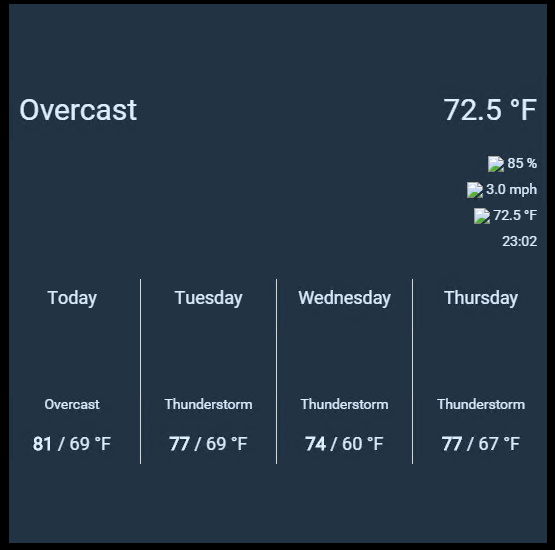

Hello, nice widget. This is my first foray into HabPanel so I apologize if this is something simple I missed.
I have installed the widget, and downloaded the icon files and set things up according to your instructions.
When I view the widget:
all of the weather data populates as expected, the images however do not load.
If I look at the string that’s calling the image:
http://10.x.x.xx:8080/static/local-weather/weather-underground-icons-master/dist/images/humidity.png
I see the image as intended.
The three small PNG icons as well as all of the other weather icons do not load.
Any suggestions?

Thanks for the quick response.
That’s exactly how I am set up. I’m running on a Windows machine if that makes any difference.
Any other thoughts?
Squid
When you place an .html or image file in your /conf/html folder, can you view it by going to ‘http://10.x.x.xx:8080/static/file.html
If not, somethings off with your ‘/conf/html’ folder and/or webserver.
Yes, I can see the image as mentioned above by calling the URL directly
I see you have ‘local-weather’ folder name in your html root, then your ServerPath should be ‘/static/local-weather/weather-underground-icons-master/dist’.
Where do i set the ServerPath? i dont see anything editable in the widget except its name
You have to edit it in the source code of the widget.
I followed the default server path that was in the widget as downloaded, no changes have been made.
<div ng-init="ServerPath='/static/local-weather/weather-underground-icons-master/dist'; IconSet='white'">
</div>
<link rel="stylesheet" type="text/css" href="{{ServerPath}}/wu-icons-style.min.css">
You need to adjust the ‘ServerPath’ to your situation. I have updated the widget so the path is same as described in the documentation.
OK, I’m very confused…
If this line of code is in the widget:
</div>
Is that not the server path the widget is using?
And am I correct in assuming that:
is inheriting the ServerPath from the line above?
@KidSquid
You probably need to set it to:
<div ng-init="ServerPath='/static/weather-underground-icons/dist'; IconSet='white'">
</div>
‘/conf/html/’ = ‘/static/’ in HABpanel
Ok, but when I placed the files on the sever I re-created your ServerPath and have a local-weather folder.
That’s why I’m confused…the physical server path equals the ServerPath set in code.
Here’s the path on the server:
Squid
If you say a single file in html can be browsed, is see no reason the widget won’t work. Browser cache perhaps.
I will clear the cache again, just to be on the safe side.
Just to make sure are there any version requirements on OH or the Binding I need to make sure I’m at? Could this be an issue?
Squid
Yes there are version/build restrictions, look at the first post. But you wrote the .png images didn’t show as well.
Sorry to keep going back and forth on this…
This really isn’t making sense…
From the browser:
But it won’t load through the widget!
