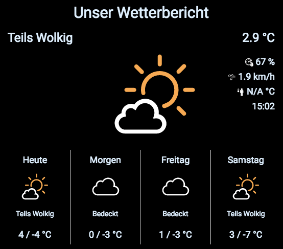

since I really like this widget, but had to update it quite a bit to fit to my local configuration, I have updated it to allow widget-level configuration of the items. Thought that might be interesting for others as well. When placing the widget, you can configure all items that are being displayed, the static directory, as well as the icon family (white or black). For installation, please follow the same logic as in @bastiaan_van_h’s post above, except that you do not need to configure the icons and ServerPath in the code (in the config parameters after placing the widget instead). The only thing that needs to be adapted/localized in the code are the names of the weekdays.
The tricky thing will be the icons… I found the easiest solution to edit the css file and rename the css definition to reflect the localized condition description. As an example, for German I would change “partlycloudy” to “teils_wolkig” (note, the widget code will replace space with underscore).
.wu-white.wu-partlycloudy { background: url(/static/weather/white/svg/partlycloudy.svg); }
.wu-white.wu-teils_wolkig { background: url(/static/weather/white/svg/partlycloudy.svg); }
Hope this is of any use for anybody else.
