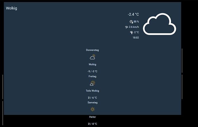

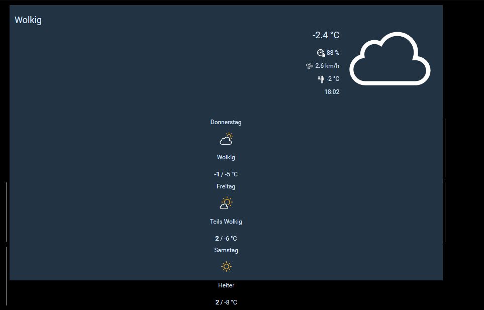

I have a problem. Widget is working but my tablet resolution is 1280x800.
The widget does not display correctly. Is it possible to modify the settings to work with such resolution.
If i resize the browser window on my PC to simulate the tablet resolution i get the same effect.

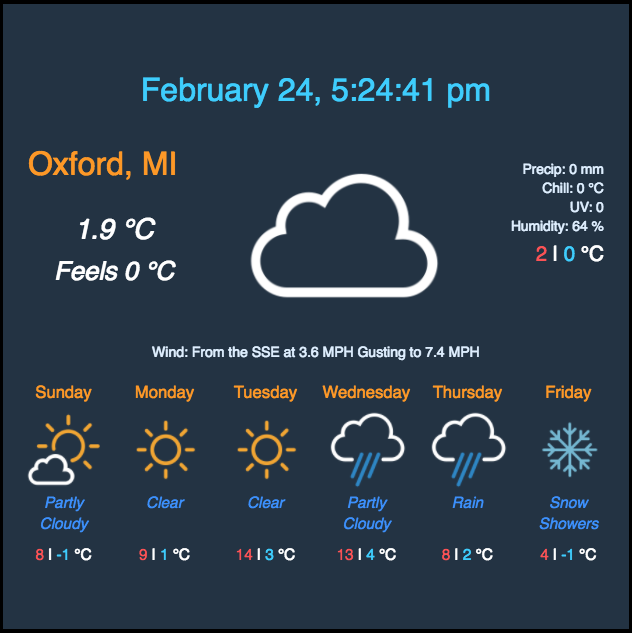

Wow, this is a nice widget, I saw another one last week and started creating my own and then this one appeared recently, it is very similar to what I was doing.
I am not quite finished but very close.
It’s amazing how much we made these very similar.
I also made it responsive (to a certain extent)
Try changing the style for the daily columns from col-md-3 to col-sm-3, worked for me…

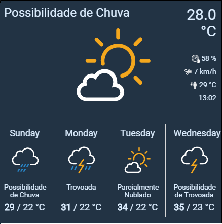

Amazing widget, thank you. How can I change the week days labels to my language?
As you can see, only the days are in English. The rest of the widget is in Portuguese.
What’s your system locale set to?
The system locale is set to my city and language set to portuguese. I changed the language and locale of my weather underground thing.
Any language that I set, except english, it’s still showing the week days in english.
@fmrenan, have you restarten OH and cleared your browser cache?
