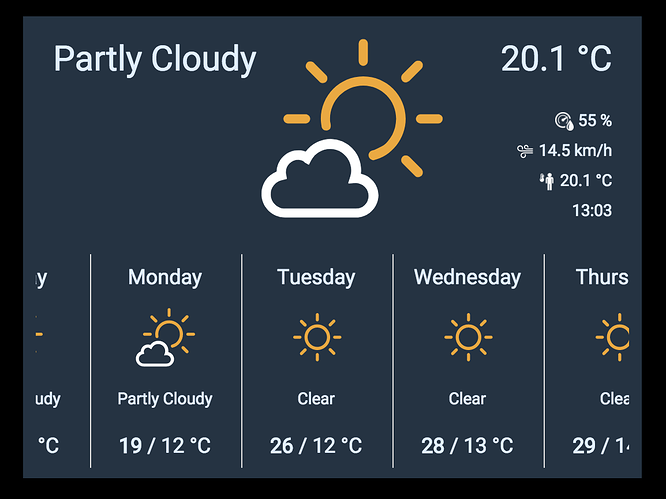

My openHab version is 2.2, running on Windows. My habPanel does not change the language as in your image. How can I see the “Setting Locale” in the developer tools?
I’m lost on how to get the IconSet icons to appear. I have this widget working fully and the ServerPath images load just not the IconSet images. They are in my dist folder under icons>white>svg
Are you sure you have the correct version of the binding? Please look at the first post and see the minimum required build number. The icon key only became available recently.
