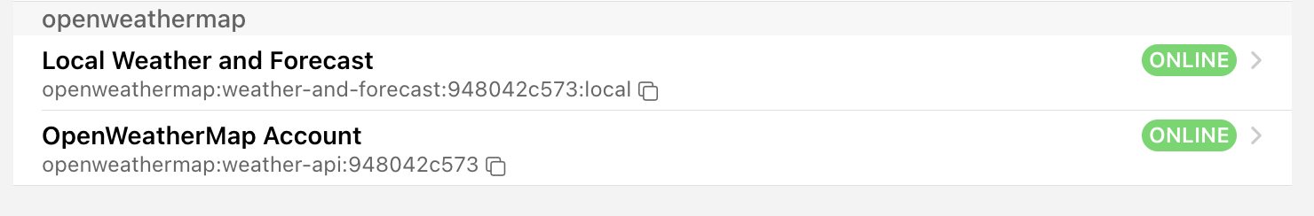

  • OpenWeatherMap thing is loaded and configured with the correct API key and showing ‘ONLINE’. UID is ‘openweathermap:weather-api:948042c573’
  • ‘Local Weather and Forecast’ thing is showing ‘ONLINE’. UID is ‘openweathermap:weather-and-forecast:948042c573:local’

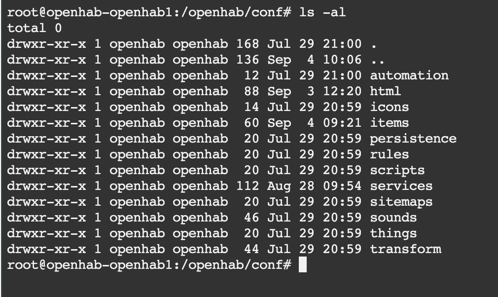

On my docker image, Openhab is installed in the /openhab directory. Within that there’s the following directories (standard openhab stuff, just showing for completeness…):
  • The provided owm-widget.items file has been updated with the my channel ID (948042c573), and placed in the items directory (/openhab/conf/items).
  • All items show up in the Items section of the PaperUI configuration page. The data is all updated correctly (and I can see we have a clear sky with a lovely 28C at the moment :slight_smile: )

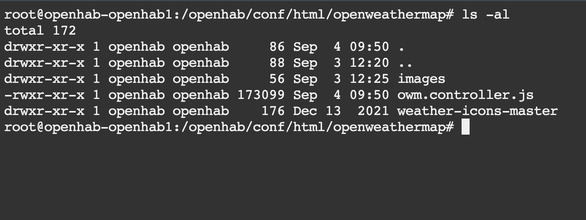

Within /openhab/conf/html, I have created the openweathermap folder and uploaded the images directory, weather-icons-master directory and the own.constroller.js file:
Although not in the instructions, I did change the privileges to 755 (or: +x) for own.controller.js, and changed ownership for all files and directories to openhab:openhab (as after uploaded the files to my docker image, ownership for these was set initially to root, which I expect would be incorrect). Before I made this change, the widget was empty as well, btw…
I then loaded the widget and added it to my HABPanel page. All I see is an empty frame…
I’m at a loss at what else to check. I would welcome any suggestion on errors I made or ways to troubleshoot further.
Many thanks,
Ronald
After hours of trying, I finally found the cause for my empty widget. For some reason my own.controller.js file was wrong.
Make sure to download the .js from this location and place it in the /conf/html/openweathermap folder.
As a side-note: On my machine, this /conf folder is located within the /openhab folder, so the .js file must go into the folder: /openhab/conf/html/openweathermap.
Hoep this helps someone else too…
