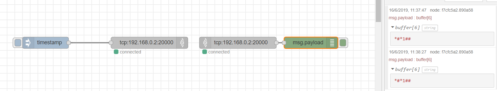

  • If I send something to the MyHomeServer1 using a simple Node-RED flow, I get *#*1## in response
