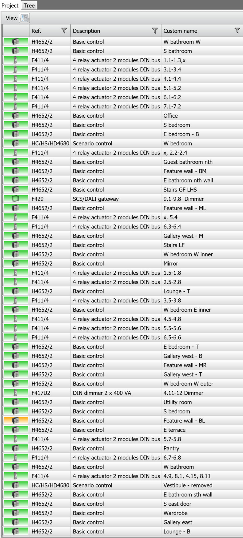

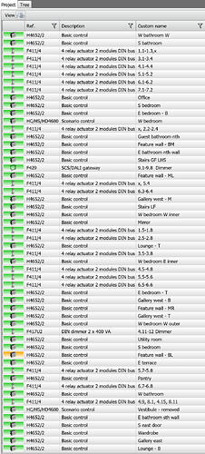

Tip: You can save the scan results as a .plant file.
Then if you want to update something or just want to review the list you can open the .plant file instead of repeating the scanning. I have separate plant files for devices, MH202 scenarios and Screen10 setup. Devices show as green when the config has been sent successfully.
