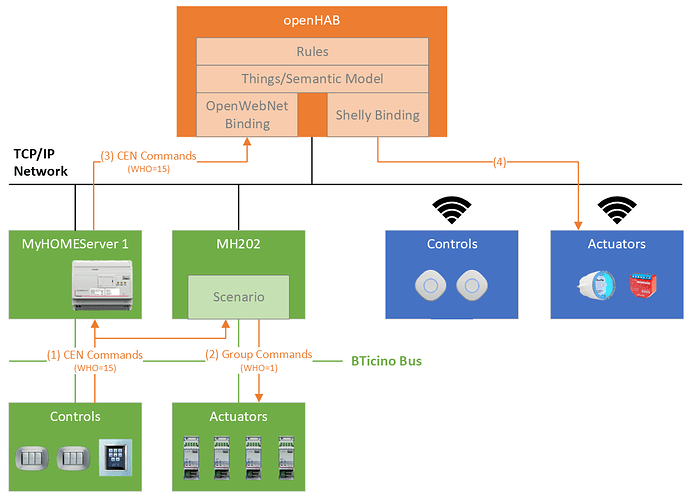

Hi Mark, thanks for your suggestion.
Probably that’s a way to do it but, after looking at the logs I was thinking that I don’t need to detect the scenario execution adding something. The proper command is already sent on the Bus from the scenario itselft:
General lights off : *1*0*0##
I will make some testing but, I’ll try to create a virtual light switch for where=“0” that like yours doesn’t have a openhab state but should map exatcly the openwebnet command for General lights ON/OFF.
What would you like the virtual light switch to trigger in openHAB?
You can create a virtual light switch with WHERE=0 for general off and it will work correctly as long as you alternate on and off in BTicino. However, if you press off twice in a row in BTicino, then there is no way to detect the second off in openHAB. The switch will not change its state and even “was updated” as rule trigger does not fire.
I logged this already as an issue:
Not sure if that is acceptable for your use case. In my case it is not and I replaced the general off command with a CEN message:
At the start of a scenario using virtual switches it starts by sending an ON to the virtual switch and at the end of the scenario it sends an OFF. So they are always OFF and openHAB only responds to the change to ON. I don’t have issue with then getting out of sync.
OK, I understand, then your use case is different. I was looking at using the virtual switches to be controlled by physical BTicino switches. For your use case, what is the advantage of using a virtual switch compared to a CEN message?
The thing/item WHERE 0 works perfectly on the Bticino side when activated by a toggle switch in Openhab: all lights turn on or off. The status of all lights is not updated in Openhab, but this is where I wanted to add a rule to reconcile.
As you reported the problem is related to the fact that my physical switch always activates an OFF and if the openhab item has received the first OFF, it no longer trigger the state change for subsequent OFF. I have tried using autoupdate false, expire=“1s,NULL”, changing the state of the item to UNDEF or NULL via a rule, but so far I have had no success
